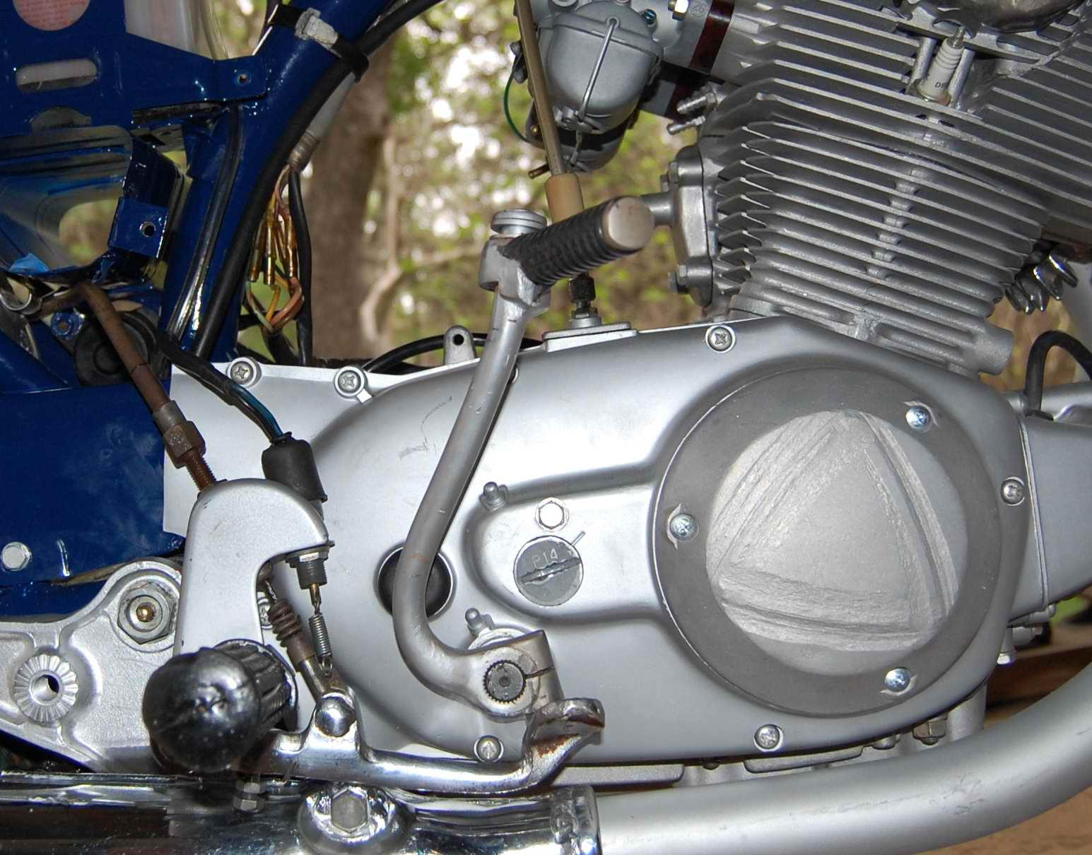

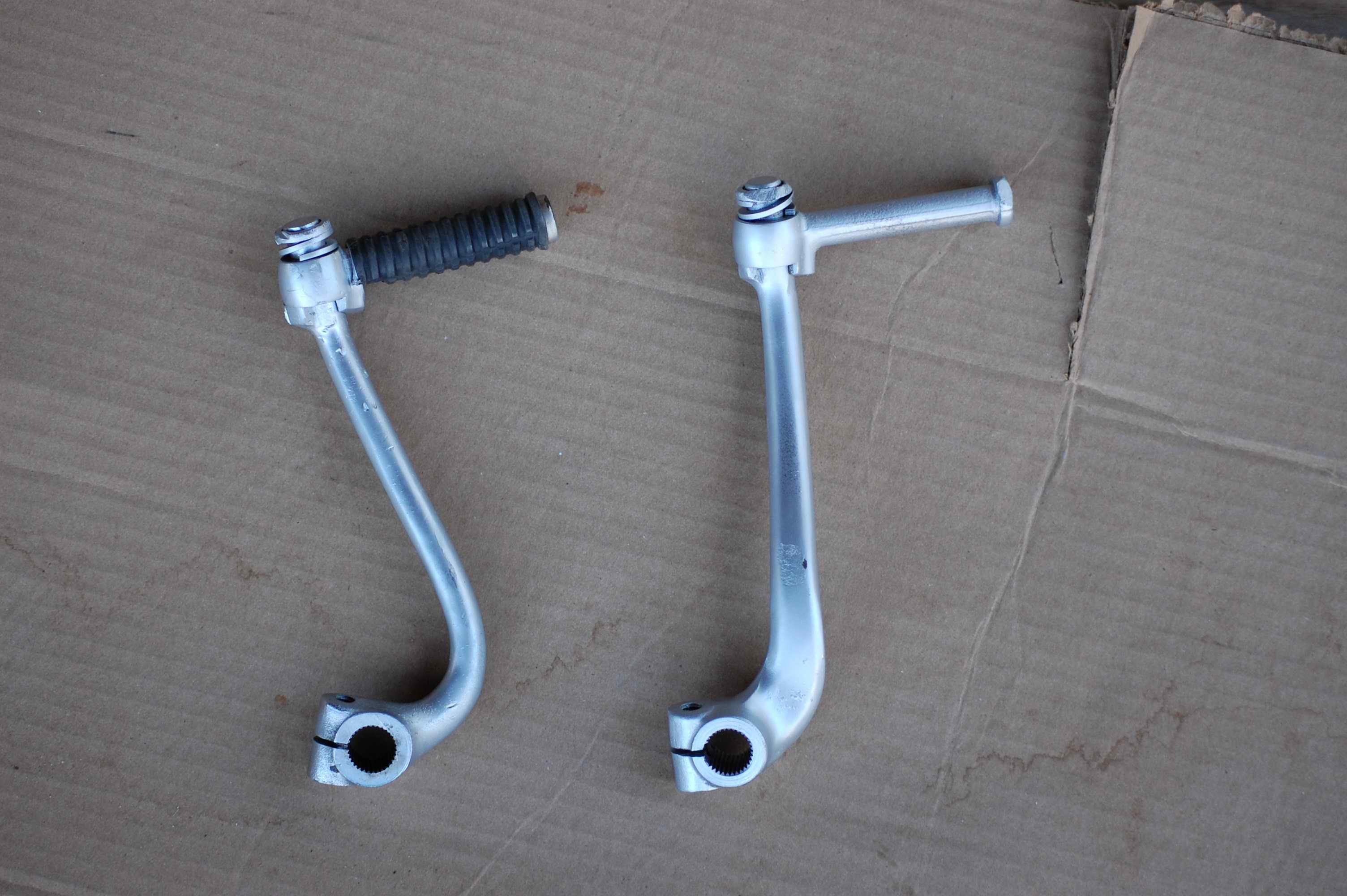

no kidding, teazer...my old kickstarter lever had gotten so bent back in the day that it gouged grooves in the rotor cover...I managed to straighten it out enough during resurrection to clear the cover, then my battery got weak and died and I had to use the kickstarter a few times...after about 20 kicks it was bent back to where it scratched my new shiny rotor cover. drats!
So I gave up straightening it and found a different one on ebay...haven't installed it permanently yet but it looks like it'll give plenty of clearance...It's apparently from a later model, quite a bit different, beefier than the one that came on my '62. So maybe the lever changed in later years even if the part number didn't...unless I got ebay'd again and my new one is from a different bike altogether. Hope this sheds some light...Lee

No you weren't Steve.
There were several parts on that bike which had been changed by someone.
I have many CB72/77 bikes from the early production and the part in the bottom pic is from another bike. ..............lm
e3steve wrote:Thanks Lee.
I...... was...... W-R-O-N-G!!!
Certainly looks beefed-up, judging by the pic.

I'll be darned...another mystery about my ol' bike...wonder what model bike that skinny lever was made to fit, a 160? Another "blame it on the Honda shop," I suppose, they did all the maintenance and repairs for me back then. I'd just wreck it, get them to fix it, and ride, ride, ride.
I appreciate you pointing this out LM. When I think I have the answer to a question I sometimes feel compelled to share what I (think) I know, but I really don't want to be passing on bad info here on the forum.
Thanks, Lee
Thanks, Lee
