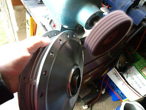

Post by G-Man » Thu Feb 25, 2010 2:59 am
Generally I only lacquer (clear coat) the shiny parts of the hub. I bead blast the finned part between the spokes and leave that uncovered. I then 'polish' the shiny part of the hub and the brake plate with a 'satin finish' mop in my bench polisher. This wheel is made like a pan scrubber in that it is plastic impregnated with fine grit.
I clean thoroughly than lacquer onto that surface with 2-3 coats of lacquer intended for use with alloy car wheels. This gives a finish similar to the stock honda finish where the hubs were 'polished' quite coarsly. The satin finish gives something for the clear coat to adhere to and is quite durable.
Satin finish 'mop' on CL77 front hub.
