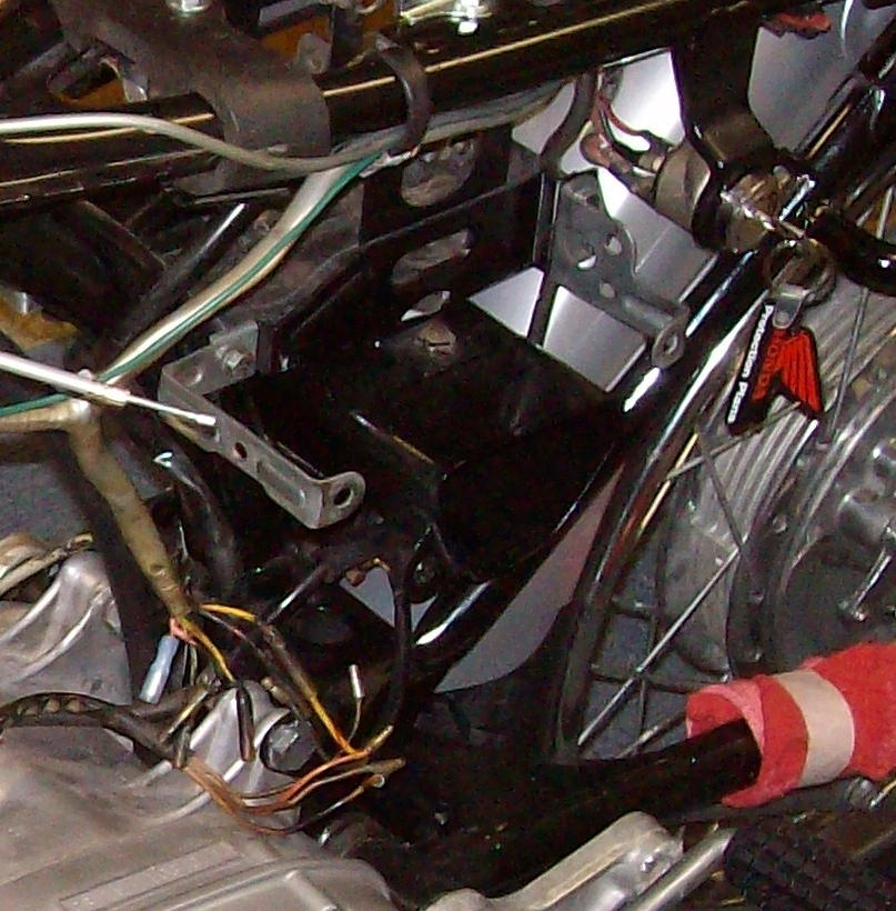

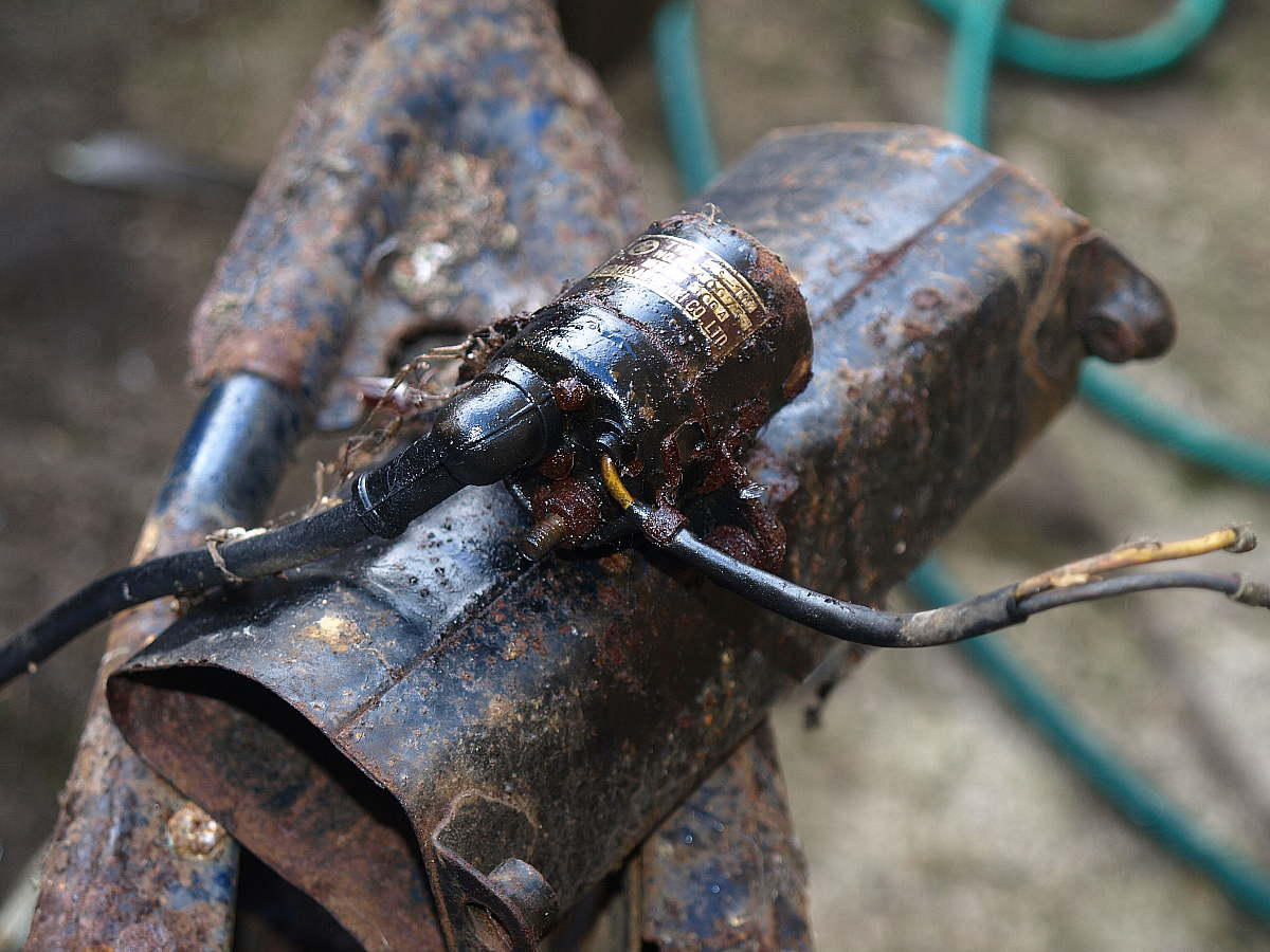

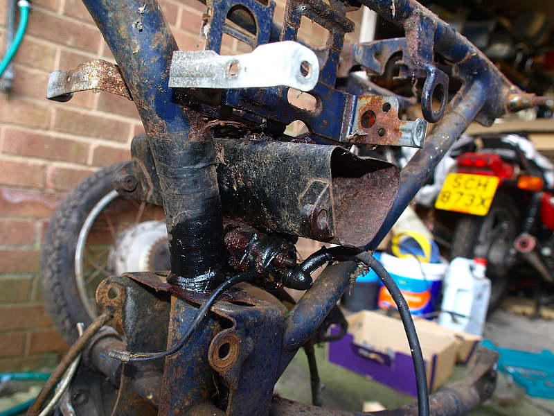

Here are a few pictures I found that may help. The first shows the box mounted without the starter solenoid, the second has the solenoid mounted, but a little hard to see.

Post by davomoto » Sat Feb 27, 2010 11:11 am
Here's a link to an NOS one for sale on Ebay. Has some good pics of what missing brackets should look like. Way overpriced in my opinion, hold out for a used one.

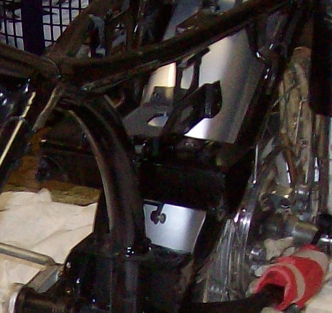

Post by G-Man » Sat Feb 27, 2010 1:04 pm
Maia
This is the toolbox off my recently dismantled CB77. Yours looks good enough just to make up and attach some little tabs with welded-on nuts.
Toolbox in place
Toolbox in place
Solenoid on toolbox
