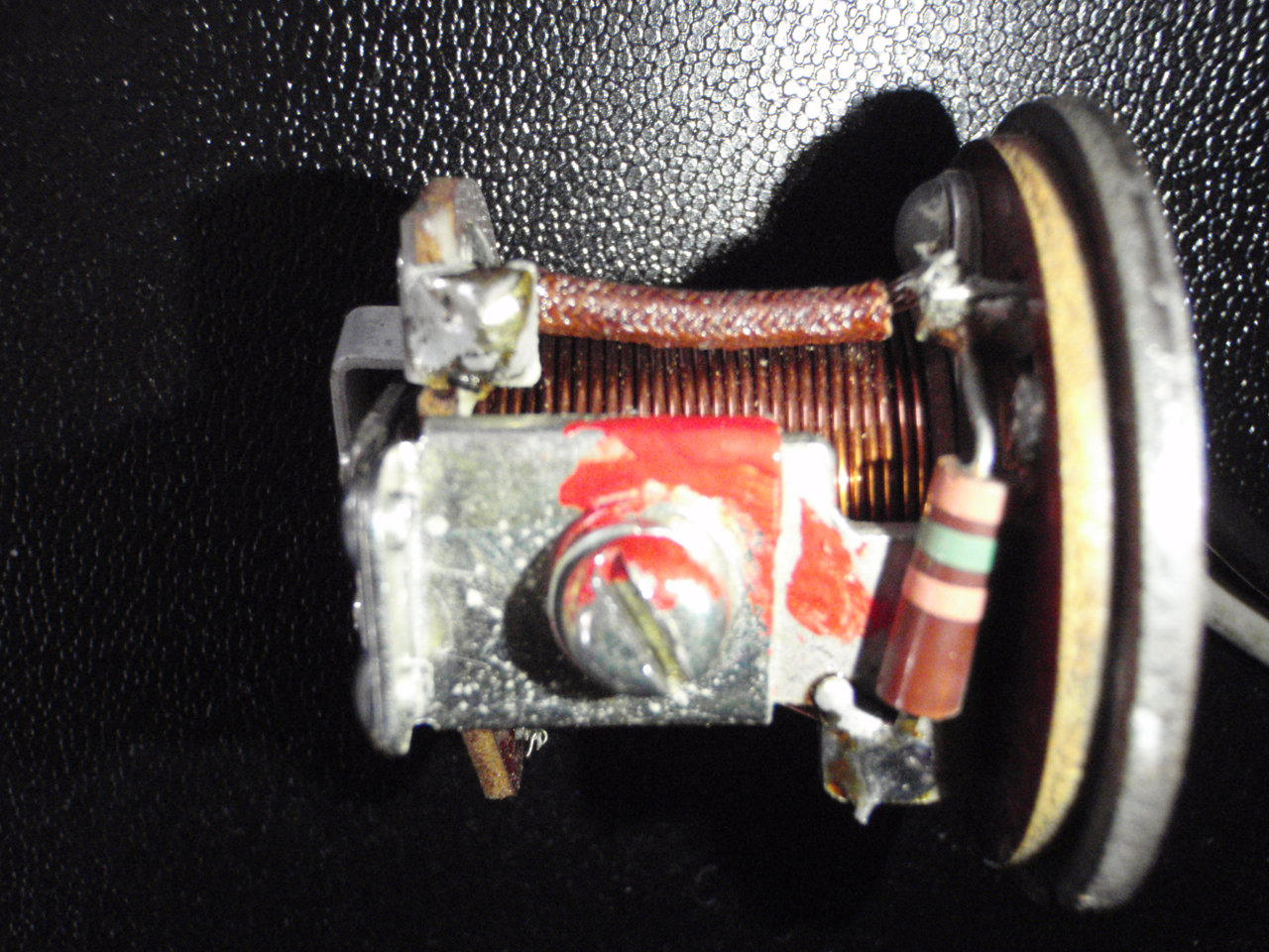

Hi,
You are able to open up the relay (pic 1), in there is a small screw (3). With this screw the relay can be adjusted (do this while the relay is fully functions, so in fly).
The best way to do this is get the relay out, and make a setup with bulbs as in your bike. Get the battery out of the bike and connect to the basis setup.
If this doesn't work, the condenser is shot (top of the relay housing). I can fix this, but that takes more effort then buying a new one.
btw, this relay belongs to a CB72, early type, not to dream. The difference is the bracket and that a dream relay uses heavier bulbs. The inside is the same, the difference between them is the little resistor for a dream it has a different resistor.
Jensen
Jensen
Geez Jensen, you really went out of your way for me on this. Thank you so much. I'll take mine apart and have a go now that you've broken it down into steps for me. Thanks again. You really are a credit to this forum. Jeff H.

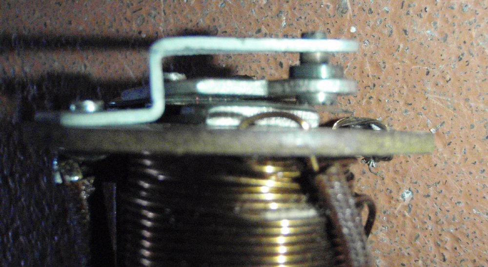

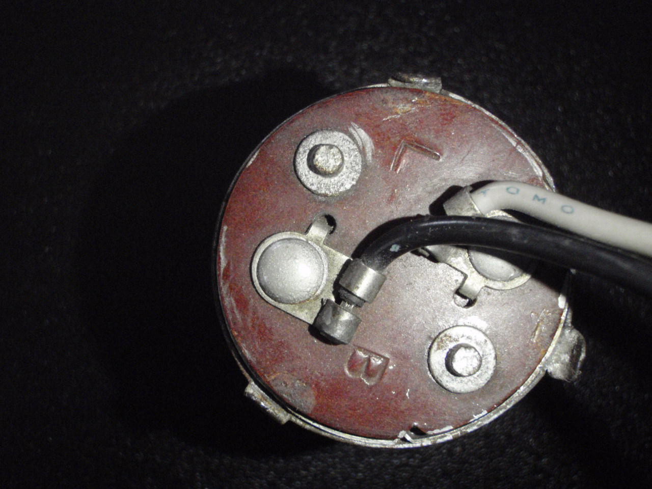

Here are a couple of pics of my flasher...
