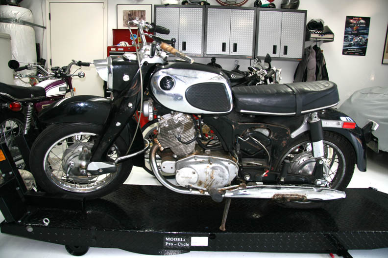

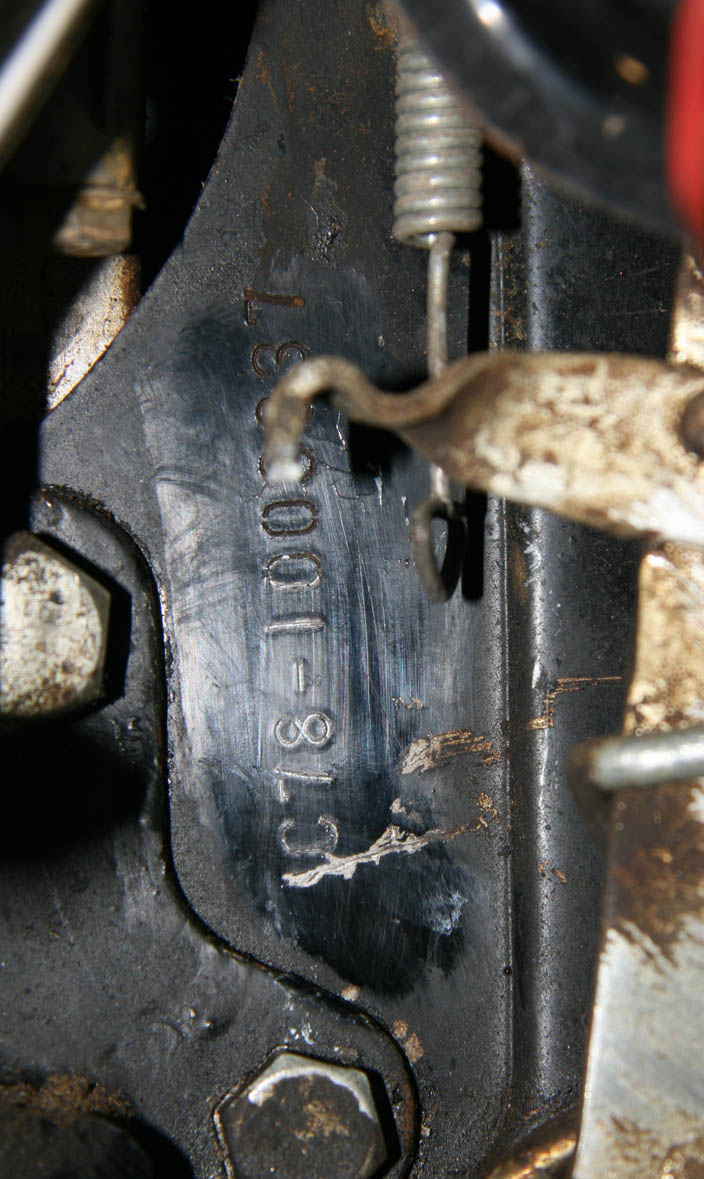

I'm new to the Dream world and I'm trying to figure out what year CA77 I have. There's not title with the bike and I have no idea where it might have been last registered. It's a beautiful black one and the headlight is not a sealed beam. Here are the numbers:
C78-1003837
C77E-1003887
Thanks!

Ya have a 1965 issue and the CA78 is a good number as it seems HONDA may have used it for the US exports.
The year of issue can be traced by the (E for engine) CA77E-xxxxxxx in the existing Bill Silver publications. .............lm

Thanks for the location info.
Ya are right in the middle of the CJMC club area. (CLASSIC JAPANESE MOTORCYCLE CLUB)
Ya do have a 65.
There is lots to know of these bikes and some (just as I) try hard and are still learning. .................lm

tobysdad wrote:So am I OK telling folks this is a 1965? Or would it officially be a 1966? I'm from Alamo, CA. Thanks for the help!

My book doesnt even have a C78 in it, i have a honda id guide from 59-2000. that stinks :PLOUD MOUSE wrote:Thanks for the location info.

Whats the diff between the c78 and the c77?
awesome bike either way. looks like a seat off a CB500 or so. thanks for the pics!
