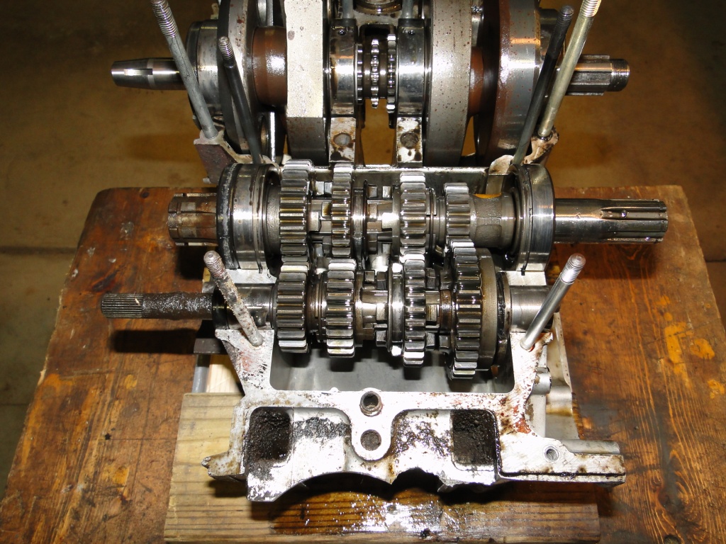

I think once i pull the rotor i'll be ready to separate the lower engine. Is there anything i need to be extra careful about? Are any parts going to go flying?
This picture has me a little nervous, it looks like the previous owner used some sort of JB weld type substance just above the rotor. I guess i'll get a better look when it all comes apart.

No, just remove the two nuts on the top case, turn it over and make sure to get all the nuts and bolts on the bottom. Tap around with a rubber mallet and it should pop loose. Don't take a chance of damaging the mating surfaces by prying. Should look something like the attached picture. Where you lose parts is when you remove the countershaft. There's a bunch of rollers in the bearing on the side where the kicker shaft comes out. They come out and bounce around a concrete floor like a Steeler fumble. Keep looking until you have 12. Take a lot of pictures.

The JB weld is there because the last person to assemble the engine didn't line the knock pin up with the hole in the bearing, and pushed it through the case when tightening the case halves together. I've seen this on more than one occasion. The JB weld repair holds up fine, so I wouldn't worry too much about it. Just be sure you don't make the same mistake!
