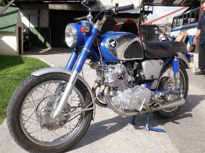

My neutral light works fine as long as the motor is not too hot. But after some 15 minutes of riding, when the motor warms up, the light doesn't work anymore. Any ideas on what could be the problem? Thanks! (cb77)
