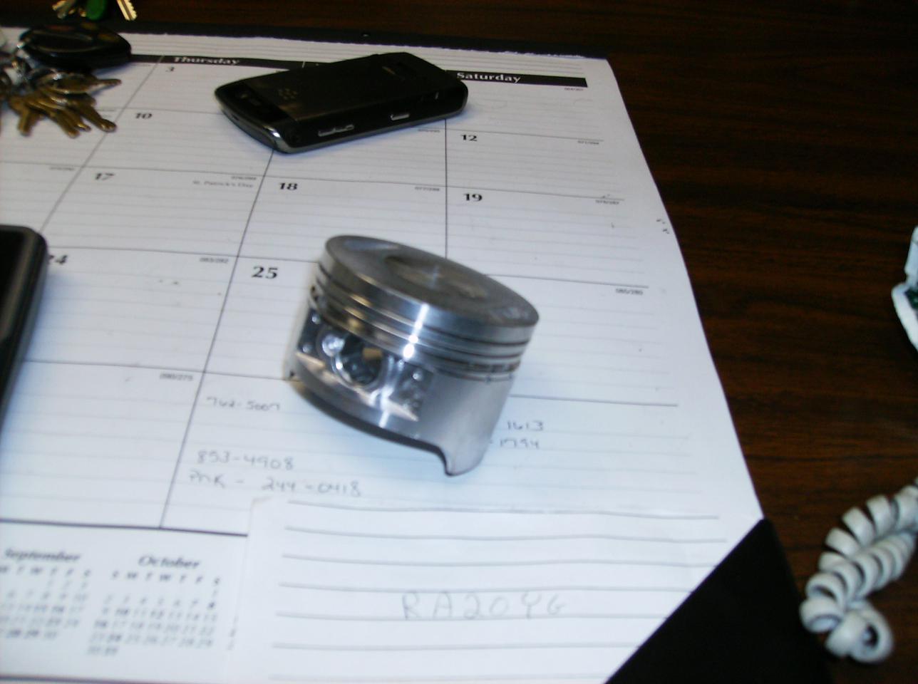

In regards to lowering the compression, I'm building a little rat bike (CL) trying to use up a bunch of mis-matched , left over, and "unusable" parts such as Broke fin cyl's and heads and super badly pitted sleeves that won't clean up at .100 over. I've come up with 63.5 MM pistons readliy available on the cheap , $20 each with pins and rings. Got mine here:
http://cgi.ebay.com/ebaymotors/ws/eBayI ... AUS%3A1123
Pin dia is 15mm and the height look to be spot on. Flat on the top and a bunch shorter than stock, but pretty much all the modern stuff is anyway. I haven't done any calculations or anything but I'd imagine it would get it down to around maybe 7:1 or so. The cyl's should end up at around .060 wall and with the lowered compression and way detuned engine I'm not really that concerned. Not gonna take this one to the drags. If I'm not mistaken these are also available in 62mm as well which would put you at around .090 wall.
