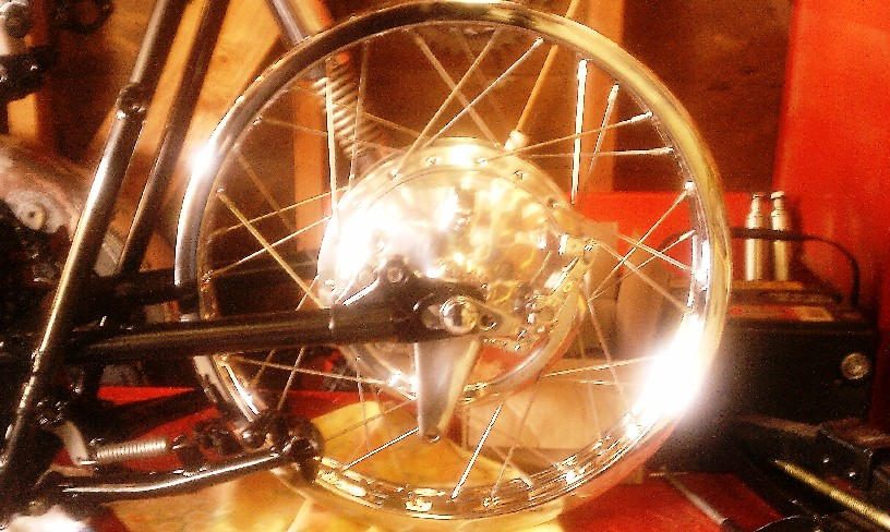

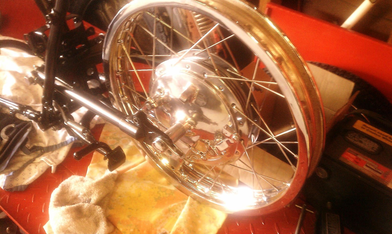

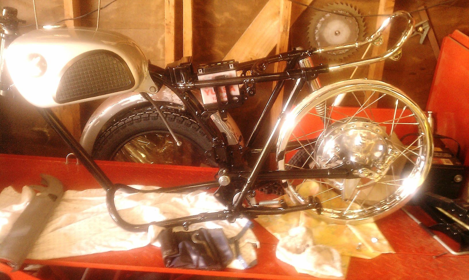

Hey Rookhill, I just had my rear rim chromed, replaced the spokes/nipples, and had the hub polished. All went well with the exception of the center part of the hub. The polisher couldn't get into the grooves but the sides came out like glass. When I got the part back, I went to LOWES and bought a couple of brass wire brushes that fit into a drill, used it on the center groove section and then coated the entire hub with clear lacquer. I have the pieces back together and it really looks nice. Don't know how fussy you are with your project, I kind of want mine to look factory or a little better. Will add some pics so you can see the end product after rechroming, polishing, clear coating, wire brushing, and adding new stainless spokes and nipples. It will take a few minutes to go out and take some pics and download them to this site. By the way, cost was about $400 for just the rear wheel to be brought back to my satisfaction.
