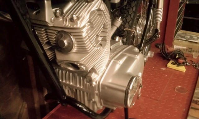

May I ask what specific media you used? I think the round glass beads come in a number of diameters or grits; don't they? Also, you're saying there's no paint on that engine in the pic?

Rickytic wrote:I used round glass beads with the Harbor Freight portable blaster, worked absolutely great and I am totally satisfied with the result.
