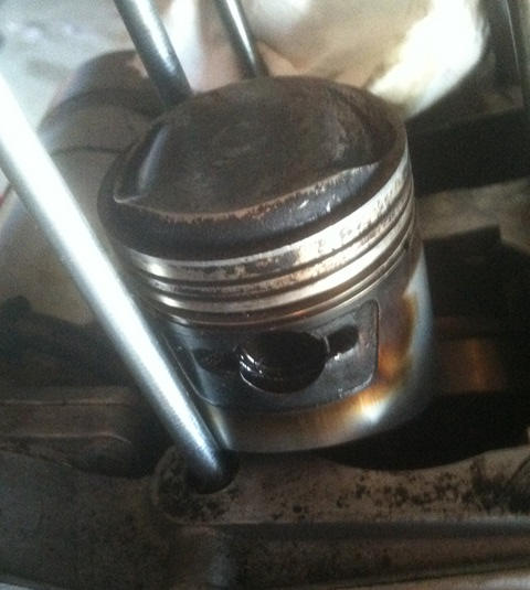

Thank you for your input, I will give the standard rings a try, I mostly was concerned was he compression readings I was getting, Since I don't have a specific ca160 shop manual, the compression should be 160 psi correct? The power loss I feel when trying to drive it, is that the engine feels like it cant get up the rpms. the lower range is fine but not much mid range or no top end, the engine will just bog down and stay in lower to mid range at best. I replaced the plugs and checked after riding for maybe 20 to 30 min, and seem decent not running lean.
I am attaching picture of the piston, don't know if that indicate anything. the cylinder's were not tarnished like piston , just shiny smooth.

Post by G-Man » Mon Sep 30, 2013 1:57 pm
Certainly looks like you are getting some blow-by but the lack of performance you are seeing is quite substantial.
35mph seems very poor. I would have thought the bike would exceed 50mph even with a tired engine. Even with the measured 120psi I would expect better performance than you are getting,
