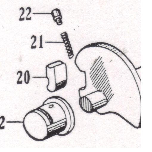

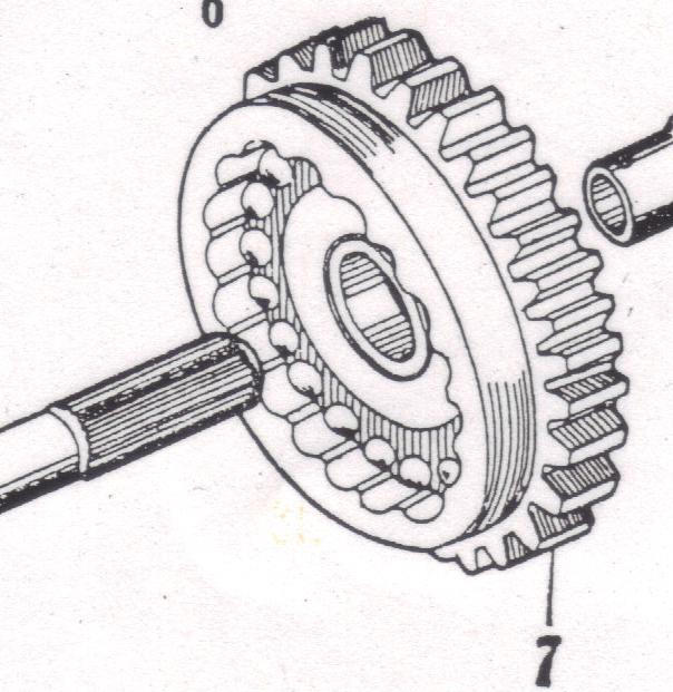

I am trying to rebuild my CB-77. I am an experienced CB-77 rider, from 1964 and more recent dates, and my current problem is a ticking noise. I have put the pieces back together, and I am looking at the upside-down engine, with everything in its place. The bottom cover is not installed ... but it has been, and the ticking noise persisted.
I have the Parts Manual, and on page 53 many transmission parts appear,
including the parts that are puzzling me right now. Part 19 is the Layshaft,
on which part 7 is a large gear with circular notches on its inside surface.
Part 20 is a small piece of metal (if it was a gun I would call it a sear) that
wedges part 7 so that it can turn in only one direction.
I know the Layshaft does not turn when the engine is running, but part 7
persists in turning, so part 20 clicks against every interior tooth of part 7.
If I simply continue with what I have, will the engine oil's viscosity prevent part 7 from
turning, or have I overlooked something? I am very puzzled by this, and am willing to
put significant expense into solving the problem. The bike has been off the road for
way too long.

With the tension of the kickstart spring on the shaft the ratchet will be held against the stop in the lower case and not be in contact. When putting the lower case back on you need to make sure the stop does not interfere or if you have removed the bolt stop you need to make sure there is no interference when putting it back in.

Thank you, Kevin. I am sure that advice is correct.
I remember, on occasion, nudging the kickstarter while the engine was running,
and of course the ticking noise commenced and continued until I let the starter
return to its stop.
I just am not sure how to achieve the goal. I must refer to the diagrams in the parts
manual, and to the instructions in the service manual (not very easy to follow!), and
make sure I get it together properly.

I am still a grasshopper ...
... or so it seems. But I think I have learned what I needed to know.
When I study the diagram on page 54 of the Parts Manual, I finally see what you meant.
Part 24 is the "kick starter stopper". As you explained, when I screw this into the lower case, it stops the kickstarter from rotating back past its rest position, and also depresses part 20 above so it does not interfere with part 7.
Success is within my grasp.
Many thanks. More reports soon.
Keith
