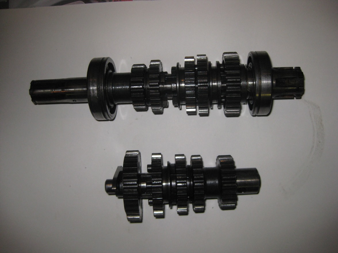

Hi I have a box of bits some NOS and was wondering if these are off a 5 speed box? If anyone can confirm or has an idea where they are from it would be much appreciated. Also if someone has a diagram of the 5speed gearbox components
regards
Greg

5 speed parts
Hello Waveblaster
I have a quick look at my old 5 speeder and I would say that some of the parts look the same, the dog ring and the double gear/shaft assy. + a couple of the gears but not all of them. That said as we well know Honda quite often changed the spec. of parts and there were also close ratio 4 speeders ( which I have never actually seen ) perhaps some of the others can help.
If you want to check the no's of teeth etc. we could compare them for you.
Gordon
Gordon

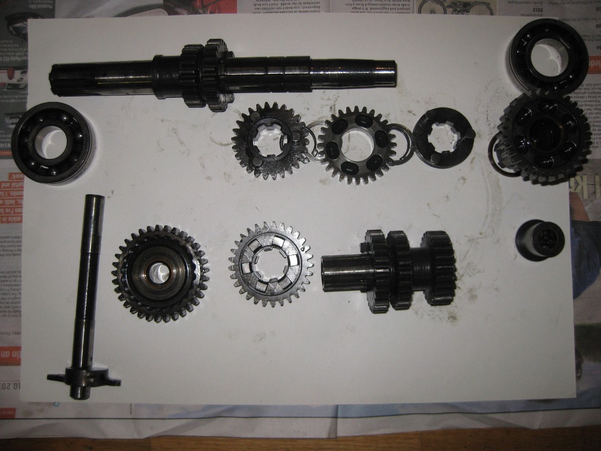

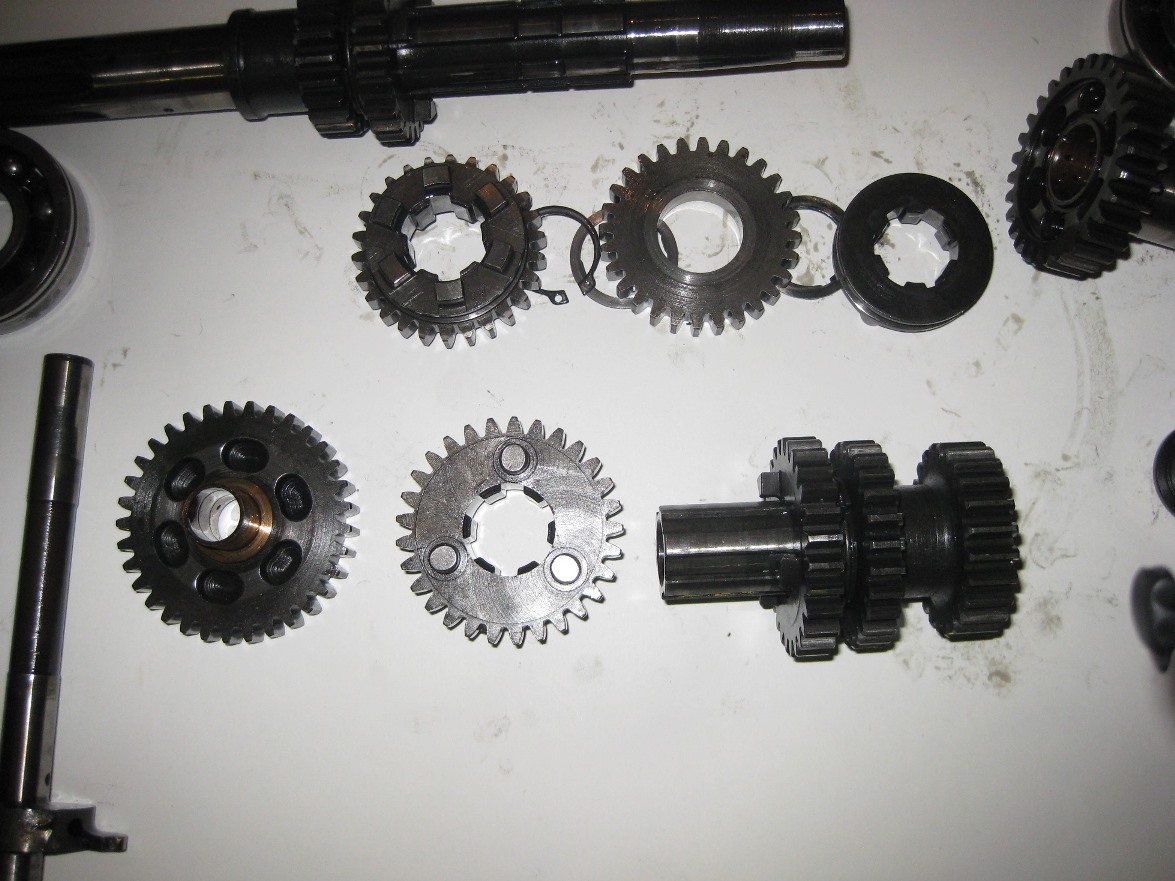

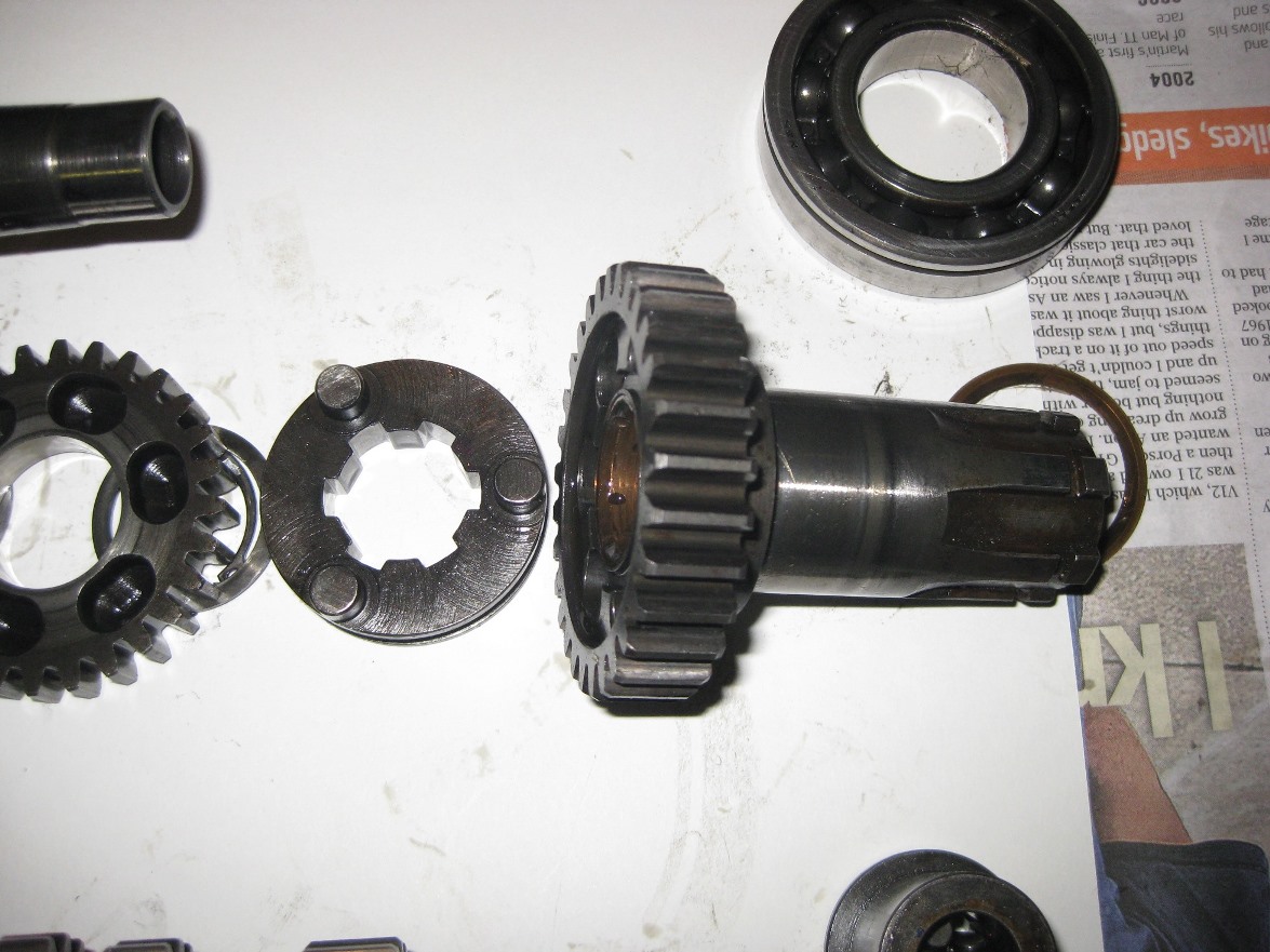

5 speeder
Hello Greg
I managed to dig out a 5 speed gearbox and take some pictures of it but unfortunately it was not at home and although I remembered the circlip pliers I forgot about the "set rings" and the measurements ( I forget more than I remember ).
Anyway along with G Man's parts list they might help identify the parts.
Gordon
Gordon
