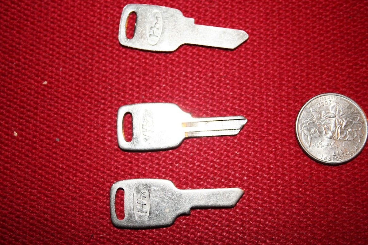

A friend on the forum has had some computer troubles and has asked me to post this photo of some Honda keys that he thought were for air pump locks, they're very similar, but they turned out not to be. Can anyone recognize the form and tell us the keys' function?

They look like keys for CA100 ignition.

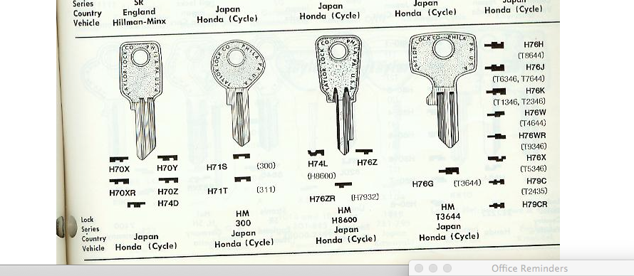

You need to search for Taylor H71S or H71T to get blanks for the pump lock. There are two different keys with grooves on different sides.
Taylor Key Blank.png (382.2 KiB) Viewed 2502 times
