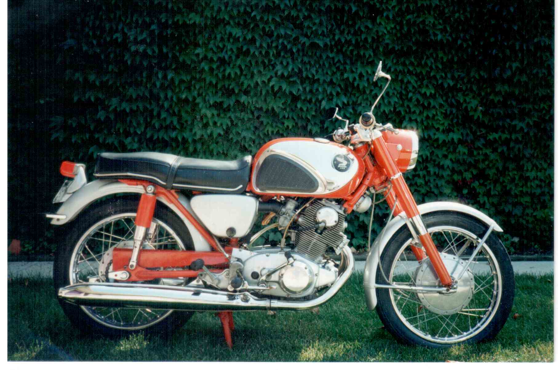

I made a chain guard for my Superhawk back in the 90's. I used a sheet of steel used for body repairs. I only made two bends and trimmed it for a good fit. I did it with hand tools and a vice. I don't have much body work experience. My scanner is acting up, but I will post a pic when I can.

Here is a scan of an old photo. I made it like a long square sided taco shell, then trimmed the bottom to my liking.

Looks pretty nice!
