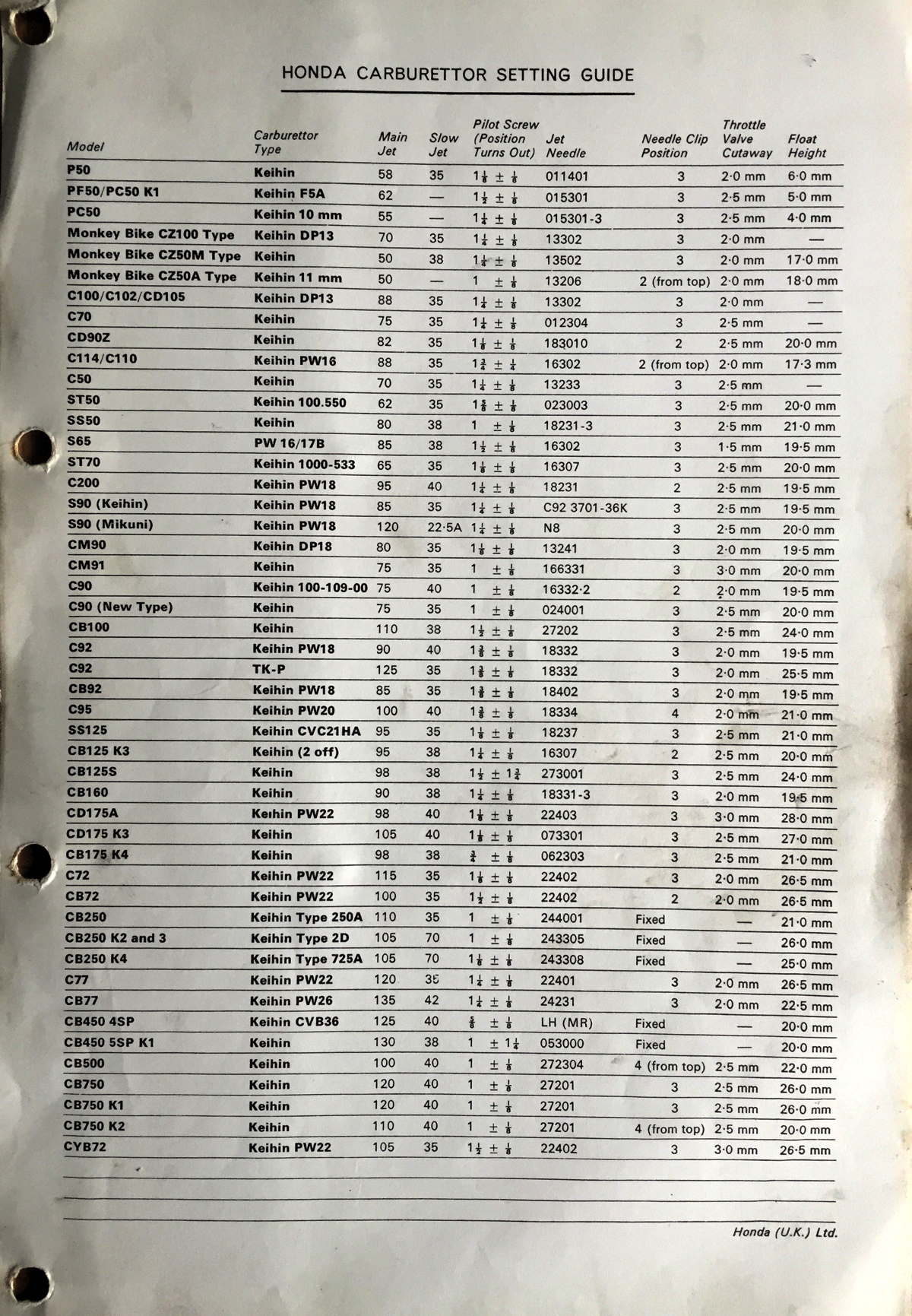

Sonds like you might want to check out the float valve condition and float height setting first.
Looks like your fuel level in the carb is too high.
Settings details on attached page

- Settings small.jpg (279.84 KiB) Viewed 4287 times

Well, been through the carb again (3 times!) this morning. The jets check out fine (by the table above). I set the float level by the guide and tested it - a bit too high for my liking so adjusted it down a bit.
