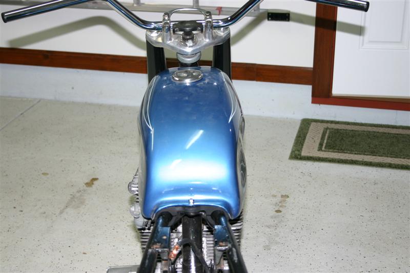

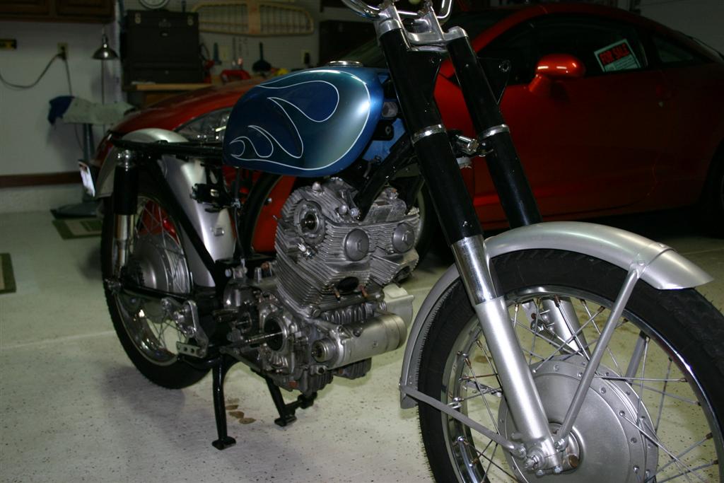

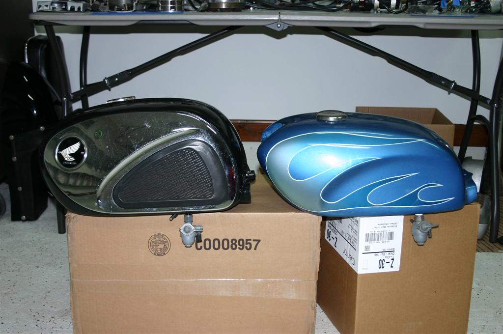

back in the day aftermarket tank. Does any one have info on this? Just purchased. Weighs 4lbs 2oz, compared to stock [11lbs 2oz]

Looks really nice.
Do you think this gas we get today will hurt it?. ..................lm

Use a good tank liner in it before use.

Been checking out coatings - the vintage mx's [Bultaco, Ossa w/glass tanks] like Caswell products

Caswell one option, heard Red Kote may be another; ethanol attacks resin. The tank has not had gas in it for years - can't even detect gas smell.
The previous owner said it was made by a company that had two or three letters as their name, but couldn't recall - any one have any ideas? I would like to find out who made this....

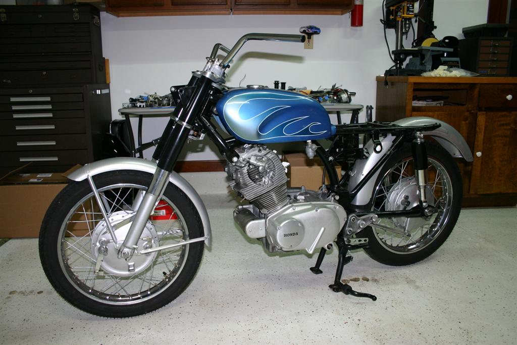

another view [trying different pic sizes]

Possibly "MCM".
A while back I took a tank to a radiator shop "They clean and coat gas tanks".
Not sure what they used. ...............lm
