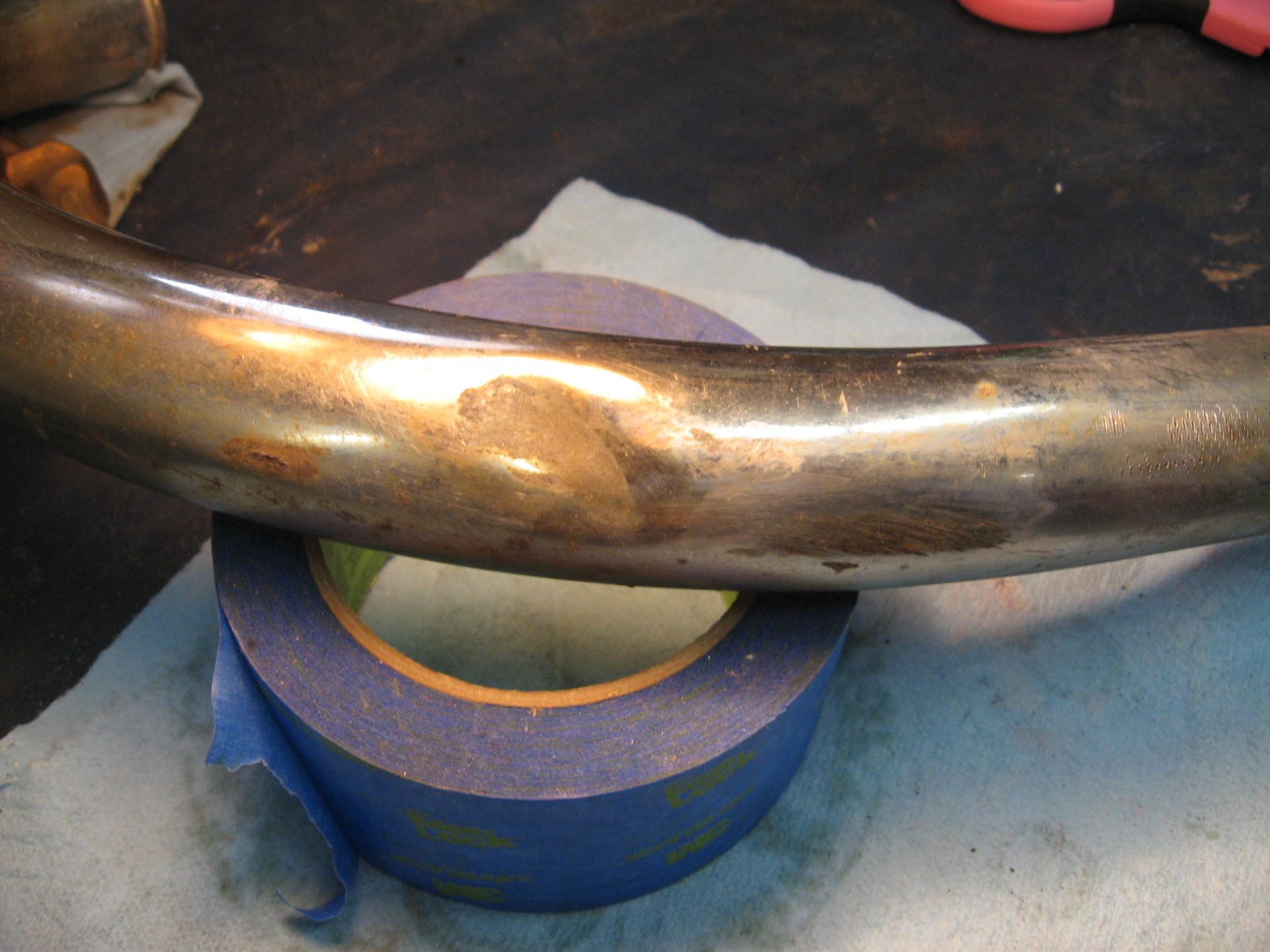

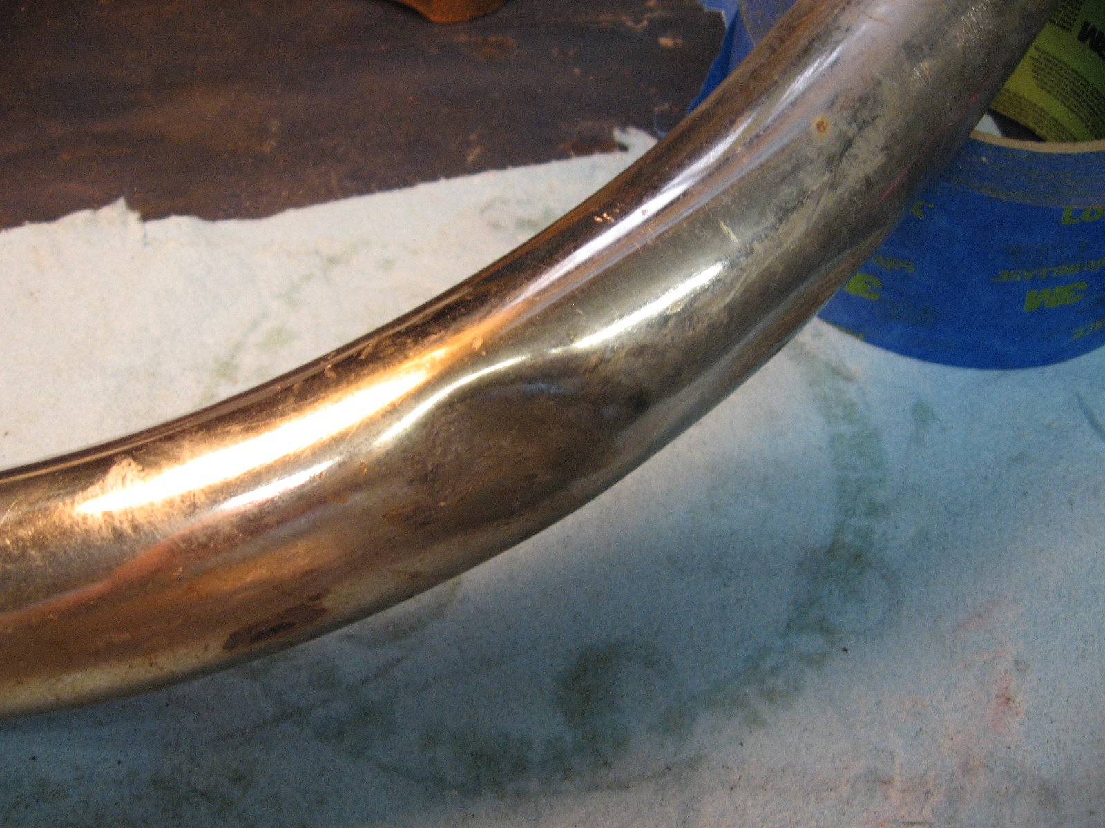

Does any one have a idea on how to remove dents? The dents are in the curved area (See Pictures).I tried to heat the area up,then used a socket with a long extension. I got some out,but that curve is a problem.thanks.ps. these pipes will be re-chromed. I just wanted to get most of it out before having them done.

Tac weld long bolt/rod on there, heat red hot and use slide hammer?
Cut hole opposite dent, heat red hot then knock out from opposite side?
