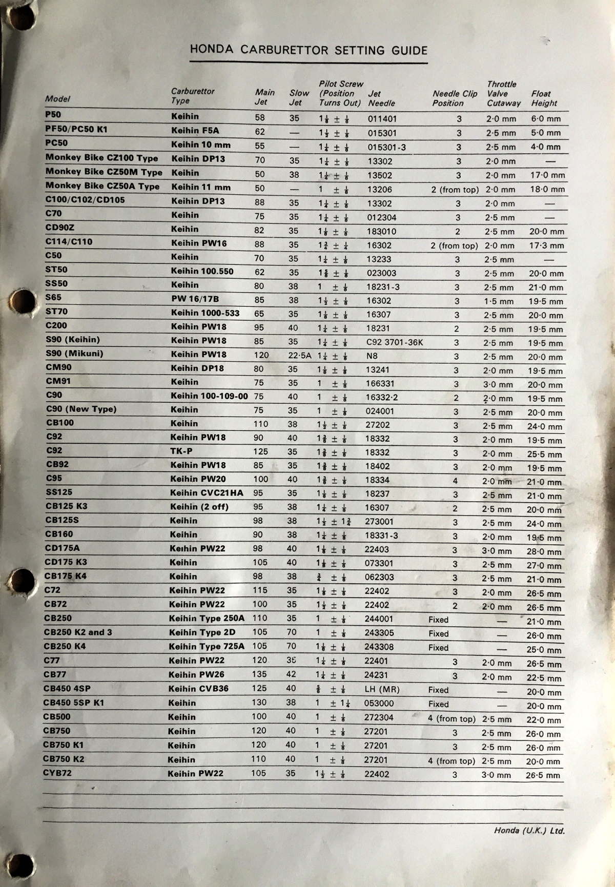

What are the stock jet size on a pw22 carb?
Post by G-Man » Mon Jan 25, 2016 3:23 am
Here you go....
Settings small.jpg (279.84 KiB) Viewed 5389 times

Post by bluejean » Mon Jan 25, 2016 4:27 am
Thanks this is a big help
