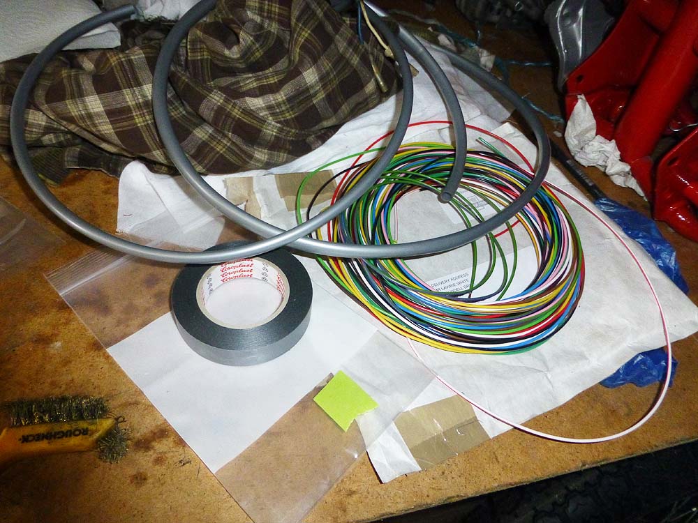

I used the above supplier for the correct silver sheathing AND silver pvc tape when I made a complete replacement loom, its good stuff & it turned out ok.
