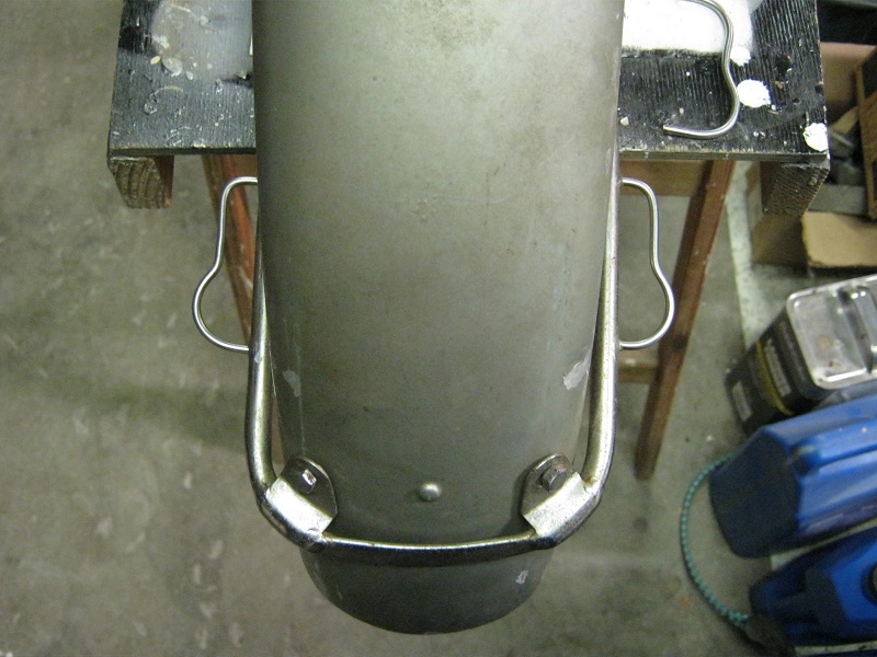

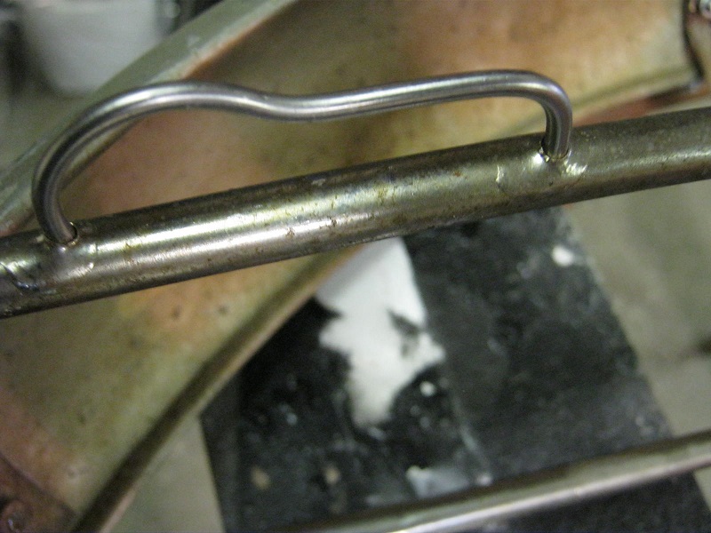

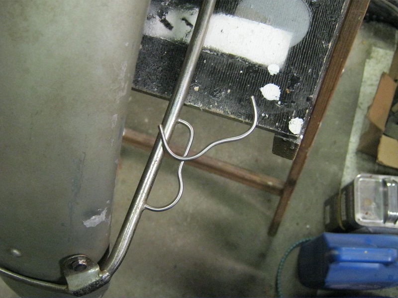

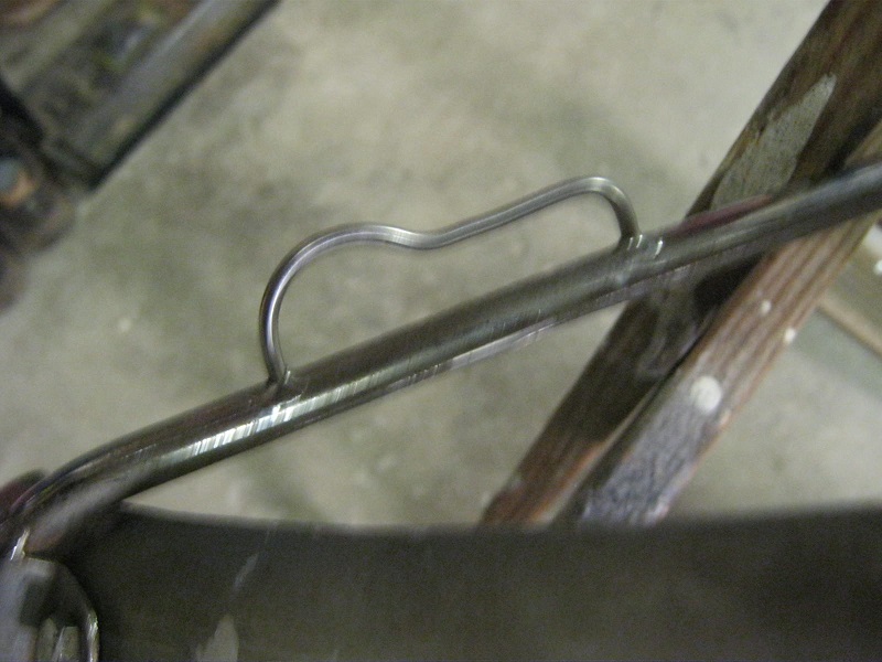

I'm slowing using up my good parts and getting into the "repairable" pieces. This fender brace is probably the best of the junk ones I had. Lots of straightening and tweaking to get the fender to fit. So far so good. However the cable loops are broke off. I bought some 1/8"stainless tig rod, made a jig to bend it into the shape of the missing loops, then carefully drilled where the existing stubs were on the brace. Fit the new into the drilled holes and next will tig weld these on with 309L stainless rod. Hopefully this will come out okay and I won't need to rechrome the brace. Several years ago I successfully repaired a welded CL muffler that had been cut off so hopefully this will work again.
Had to change out the front forks on this too, PO put too long of bolts in the fender mounting holes.
