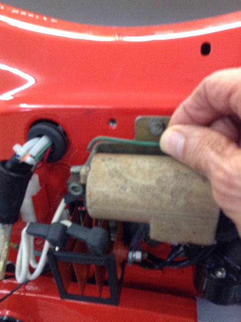

Got the bike started for the first time in over 2 years. Ran for about 3 minutes then died.
I discovered this broken wire on the coil. Can I solder it or do I need a new coil?
Second question is there a good source for coils?
Thanks,
Bob

Had the same problem with mine. I stripped the wire back,wrapped around a very small sheet metal screw, screwed it in to coil and then soldered. Worked fine.

Post by catterar » Wed Jul 06, 2016 7:45 pm
Thanks for the feedback Mike.
I'll be out in the shop with the soldering gun tomorrow afternoon.

Post by teazer » Tue Jul 19, 2016 3:57 pm
You should be able to find a low cost replica coil on ebay I would expect. There are lots of new coils out there that have become available over recent years.
