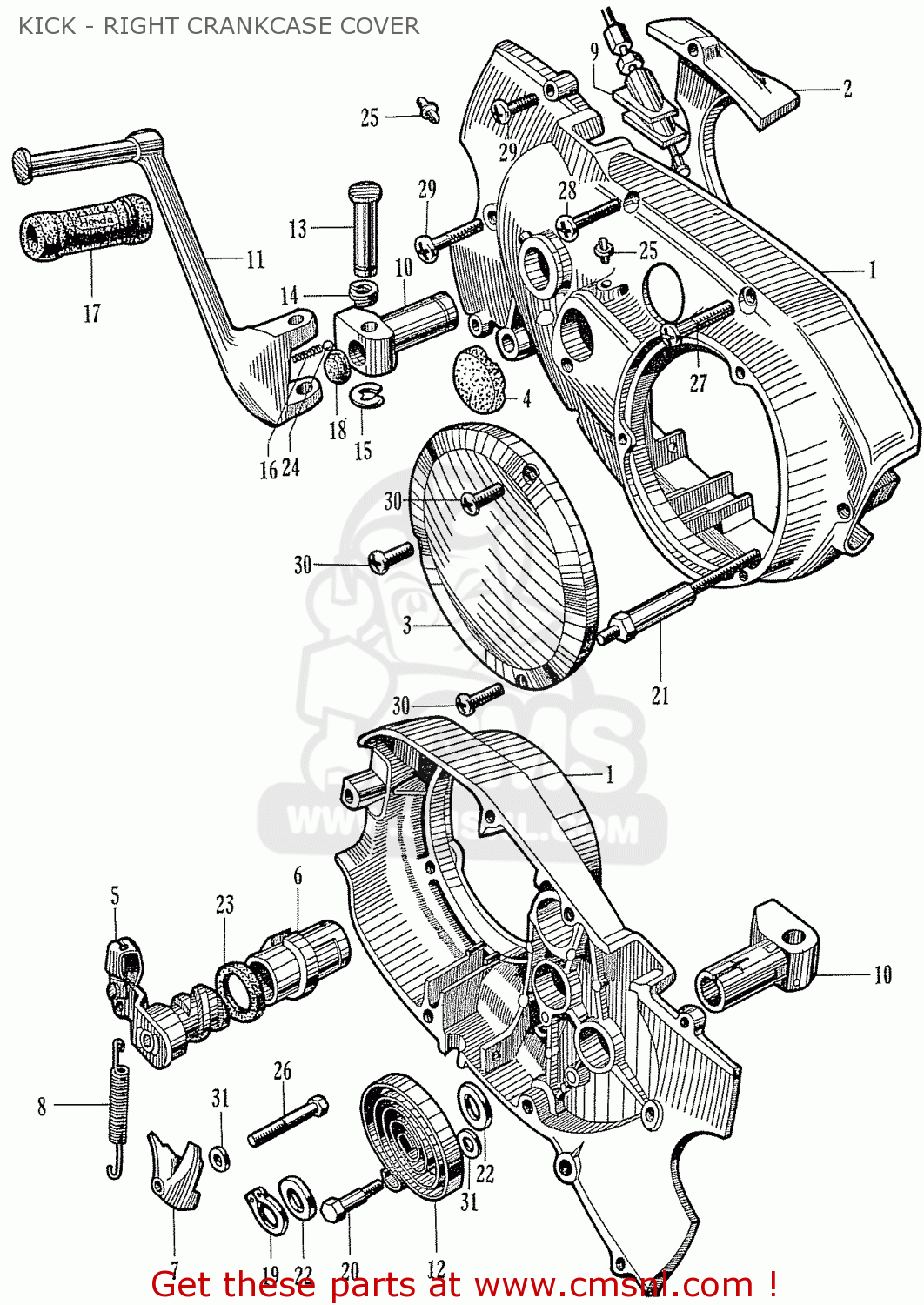

Where is this ball located at? I will be doing mine soon, but can't find it in this...

Post by Hoosier Tom » Sun Aug 06, 2017 1:27 pm
VickyBlue wrote:Where is this ball located at? I will be doing mine soon, but can't find it in this...
Wrong side cover, Blue. It is located inside the clutch lifter arm, part number 5. It goes inside the end that engages the clutch push rod.
