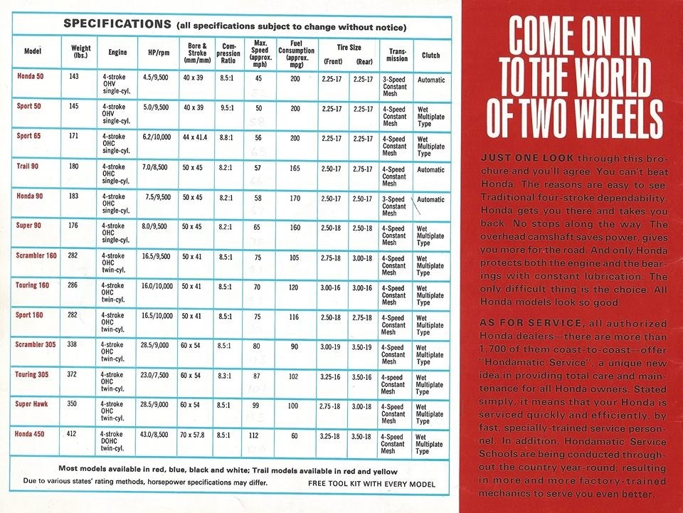

Why have we heard so many times with tire sizing that the rear size for a CA77 should be 3.25x16 when it states here that it should be 3.50x16.

Could it be that HONDA put 3.25x16 for both front and rear in the parts book? ......................lm

And in the Owners Handbook,
Could just be that is the CORRECT information?
