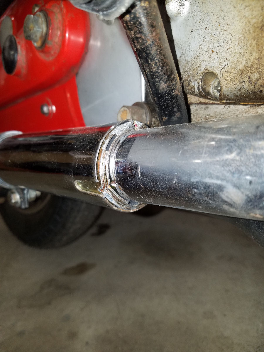

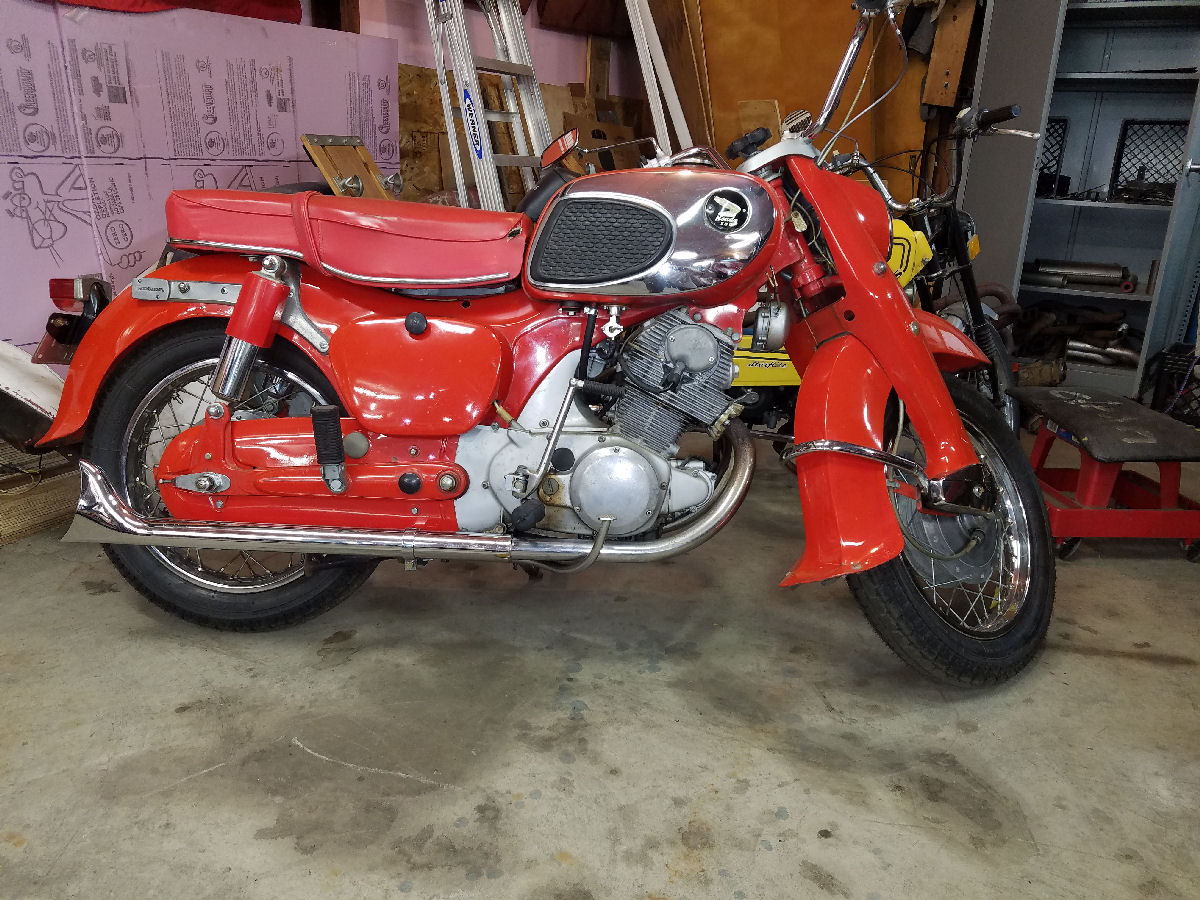

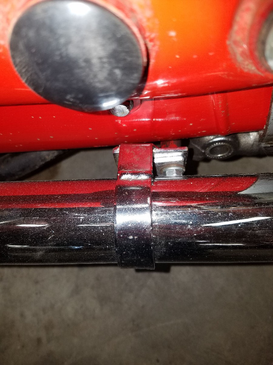

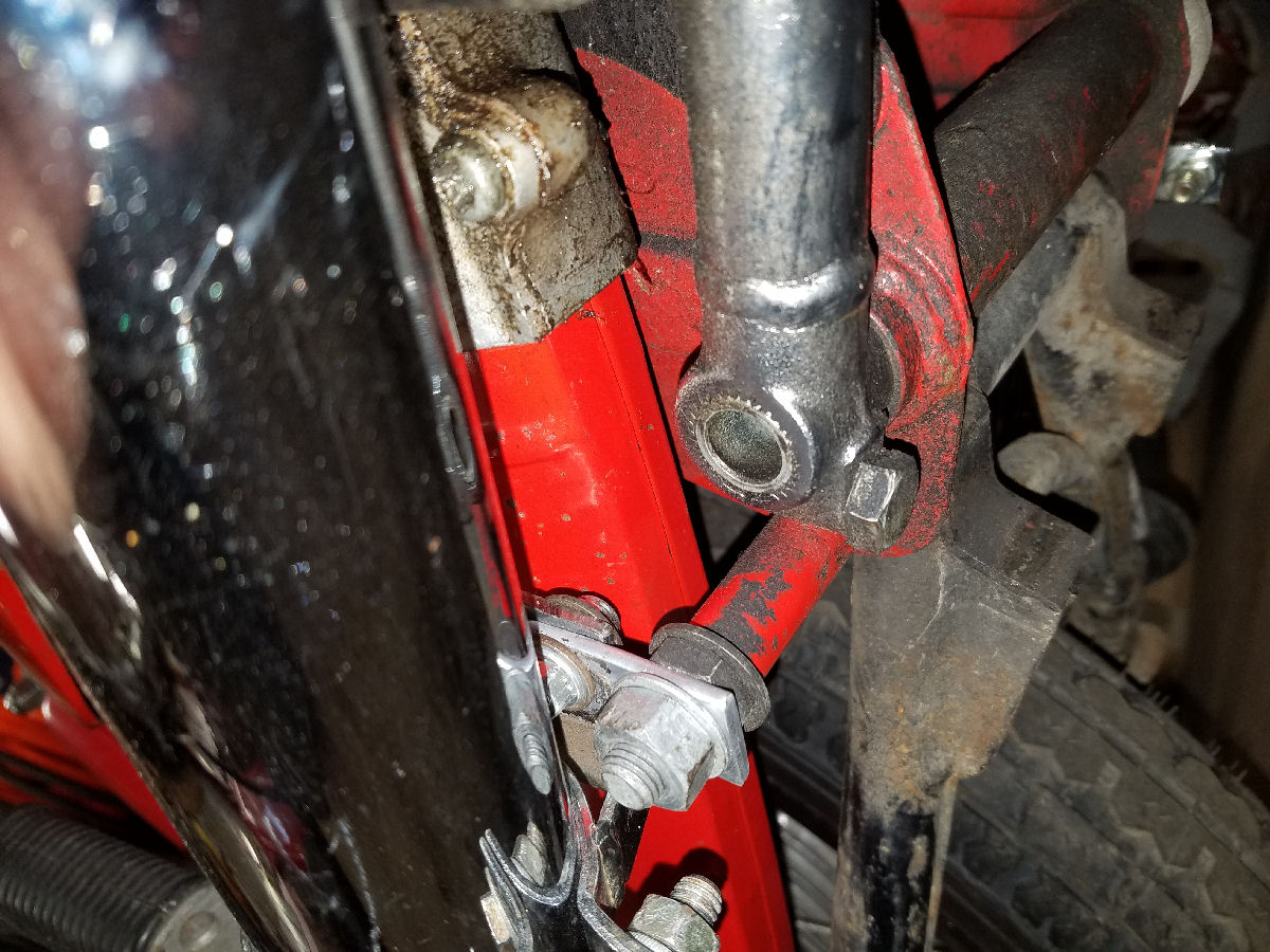

Post by danielzink » Thu May 25, 2017 6:16 pm
Here's some pics...plus my cobbled bracket ;)
They're straight pipes so yeah...they're a bit "loud"
