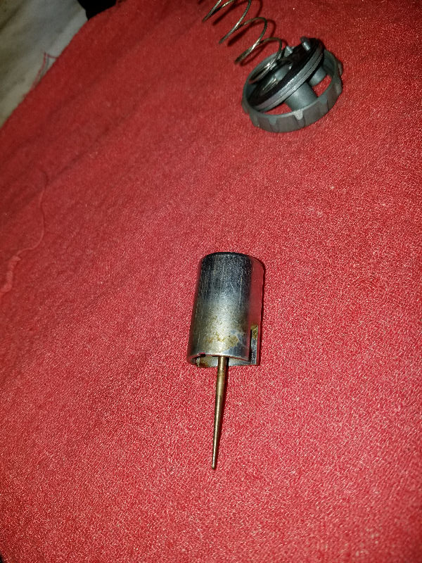

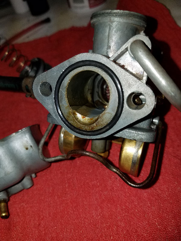

Upon disassembly tonight I found this....
The slide had a "filmy...sticky" buildup on one side...
And the carb throat ? oy....

So I removed the carb and "re-cleaned" everything....
Fixed the bent float and set both to 26.5..
At re-assembly I put all the old jets and needle back in (after a couple hour soak in the Berryman's)....
And guess what...
Runs like a "dream" (see what I did there ?)....
