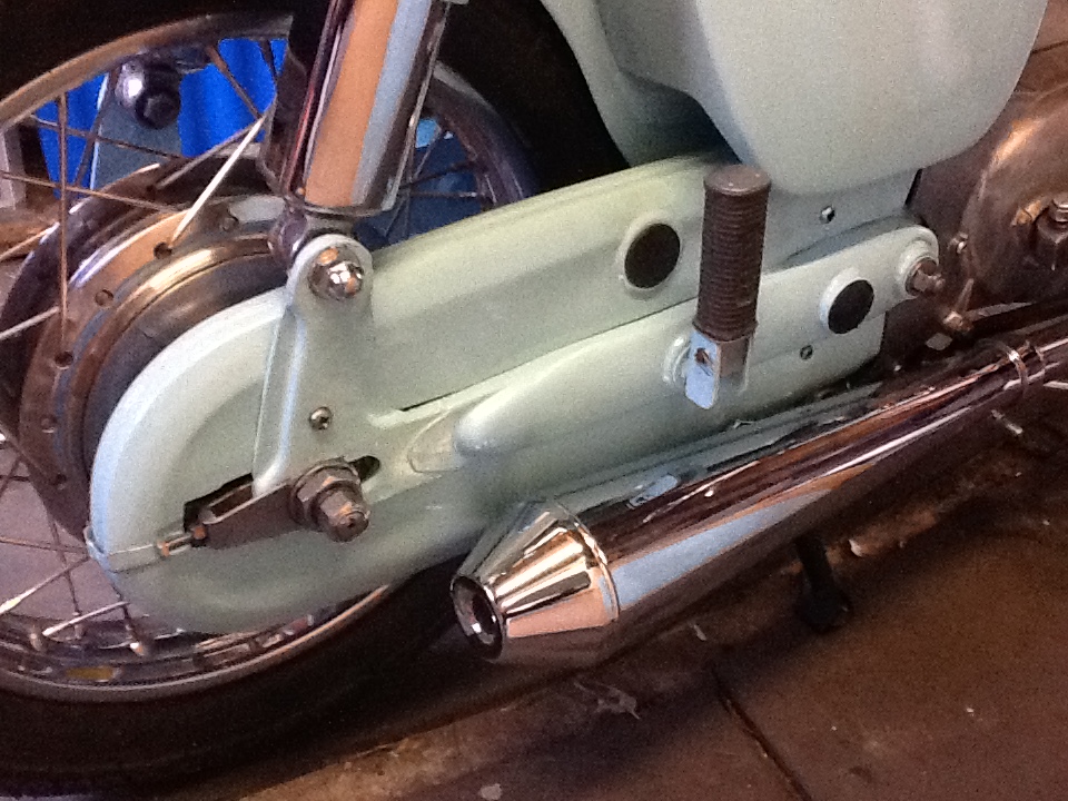

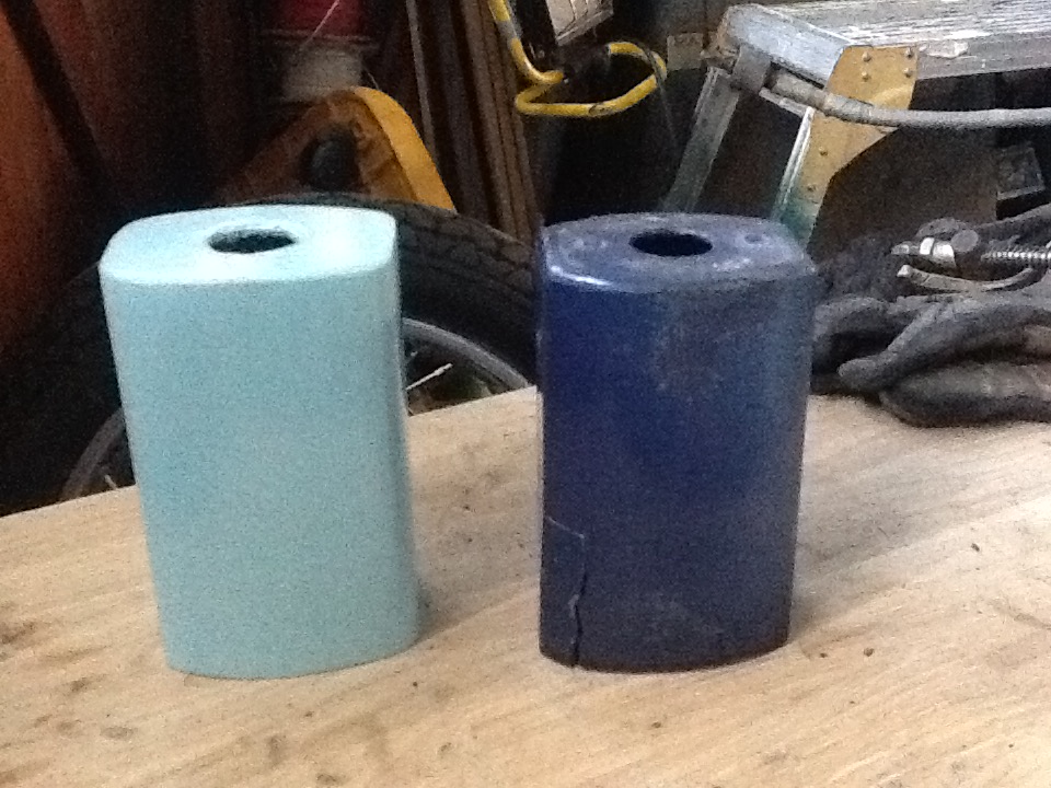

As I can't bring myself to pay the rediculous us postal rates and then customs duty I've had to improvised on my CA77 restoration. The carb covers were quite simple and I was quite pleased how they turned out. The plastic rear shock covers I made from 1mm thick sheet steel and cut the end pieces with a jigsaw and welded them up. The chain guard was one I bought brand new for a 125 Honda, it only cost £20 and the top section fitted with almost no modification except to relocate the fixing holes, the lower section however needed additional metal added along its length and a couple of captive nuts attached. If you look closely you can see the joint is upside down but as it's not an oil bath I can live with that. It also needed a skim of two pack filler to hide the seam where I had welded it up and then a coat of paint. Oh yeah, just remembered, I also made the air filter cover and the battery bracket that retains the filter cover and the battery. I used photos from eBay and obviously used my bike to get accurate fitting.

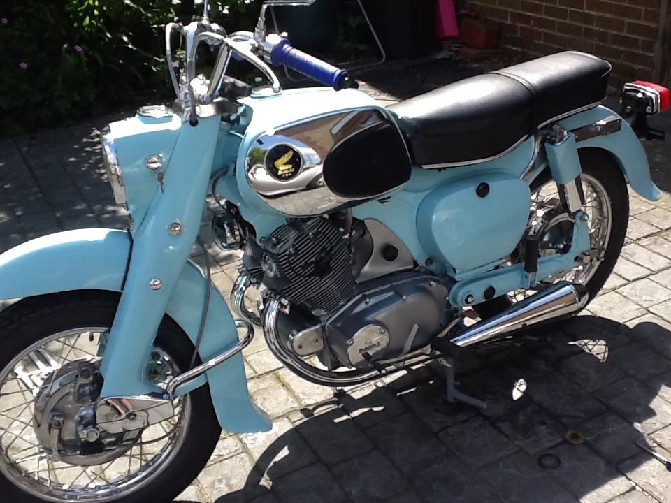

As a follow on, I wanted to do as much of the restoration as I could. I took photos of the wheels and the spoke pattern before stripping and polishing the hubs. I got the stainless spokes from Tailand and the rims in the uk. Trueing them up is not as hard
