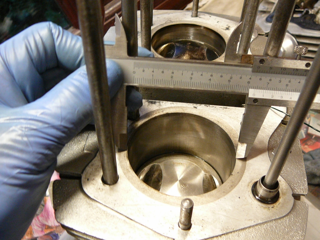

When I purchased my CB77 I was told it had a 350 conversion but given that not everything else has been as claimed I wanted to check for myself.
The good news is that it does seem to have one, I have measured the bore at about 63.75mm.
The problem I do have it that it seems to have a standard CB77 head gasket, measures about 62mm.
So question is where can you get a suitable head gasket, are there any from other models that are suitable or anyone sell specialised product?

P1060684 (1024x768).jpg (132.69 KiB) Viewed 4631 times

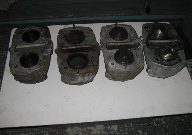

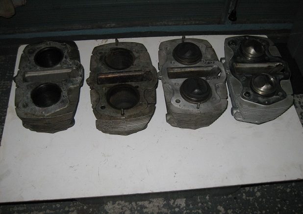

If the liners are still fairly thick then they are most likely replacements as the STD ones are very thin at 63/64mm bores. ( would you believe the liners in the four cylinders in the photo are all different ), From the photos it looks like the pistons are modified ones from another model, Kawasaki or Honda perhaps ? or even a period aftermarket make.
If you could post some photos someone might have the answer.
