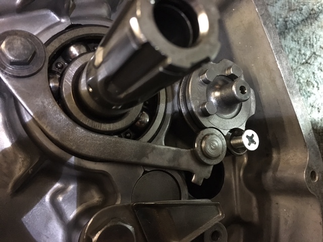

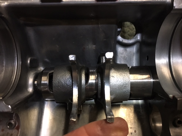

Thanks for the pictures Rusty. My transmission does look like the one in your pictures. I figured out how to attach pictures (the file size was too large last time). I have attached a picture of my shift drum & forks and the shift drum stopper. The position of the shift drum stopper should be 1st but is actually neutral. Still trying to determine if I have installed something incorrectly or if the transmission is just "sloppy" because the engine is not running.

It looks like your shift drum retainer bracket is installed on the wrong side of the drum. It needs to be installed above the drum, not below it. It will not operate correctly if not oriented properly.
HT

Post by Mrburnn » Thu Oct 19, 2017 9:18 am
Nice catch, yes I did have the retainer installed upside down. Unfortunately I still cannot operate through the gears, even using the shifter arm. I'll keep working on it, must be something simple I am overlooking. Thanks for taking the time to reply!
