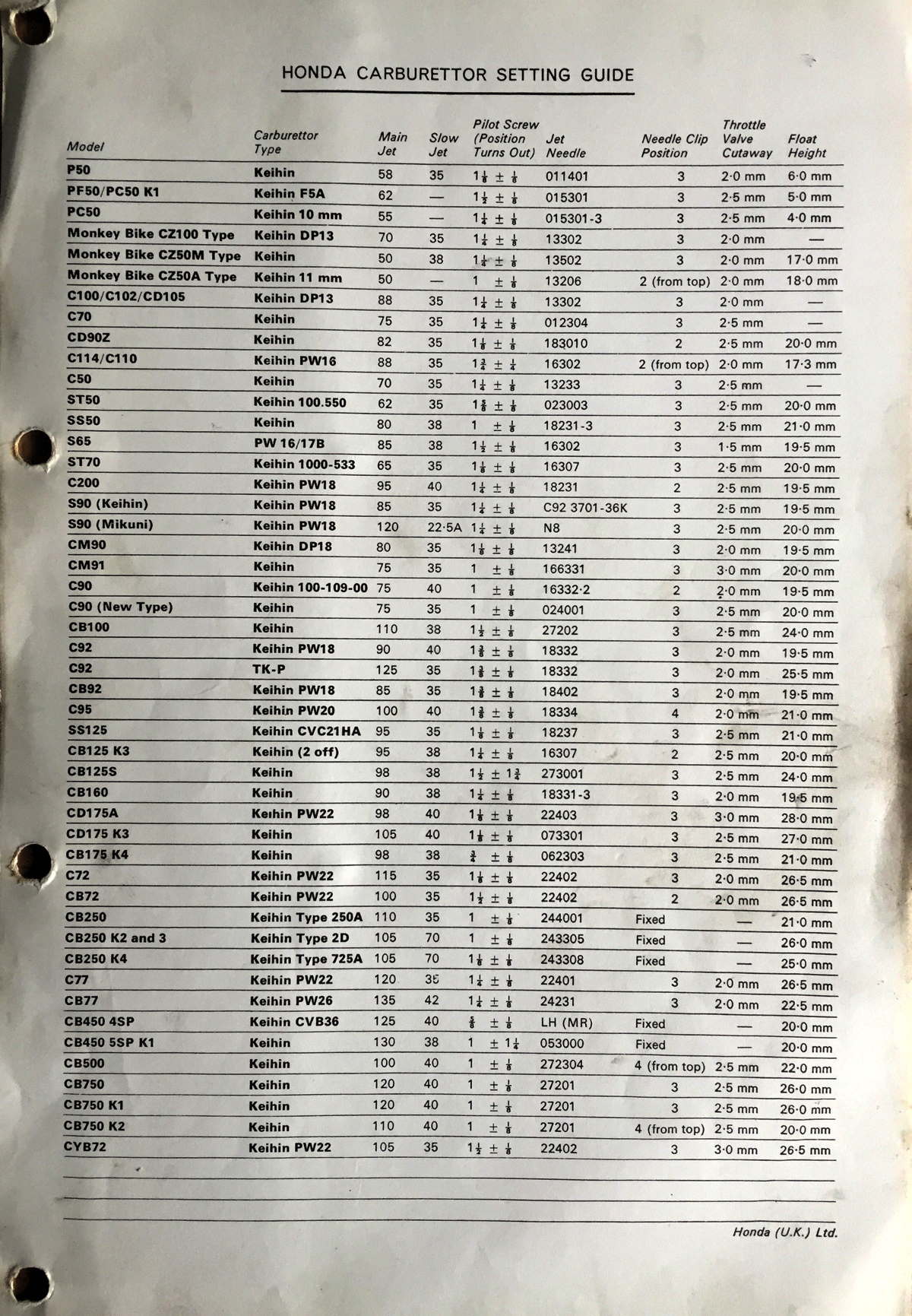

Post by G-Man » Mon Nov 20, 2017 1:39 pm
Carb settings...
Settings small.jpg (279.84 KiB) Viewed 4860 times
