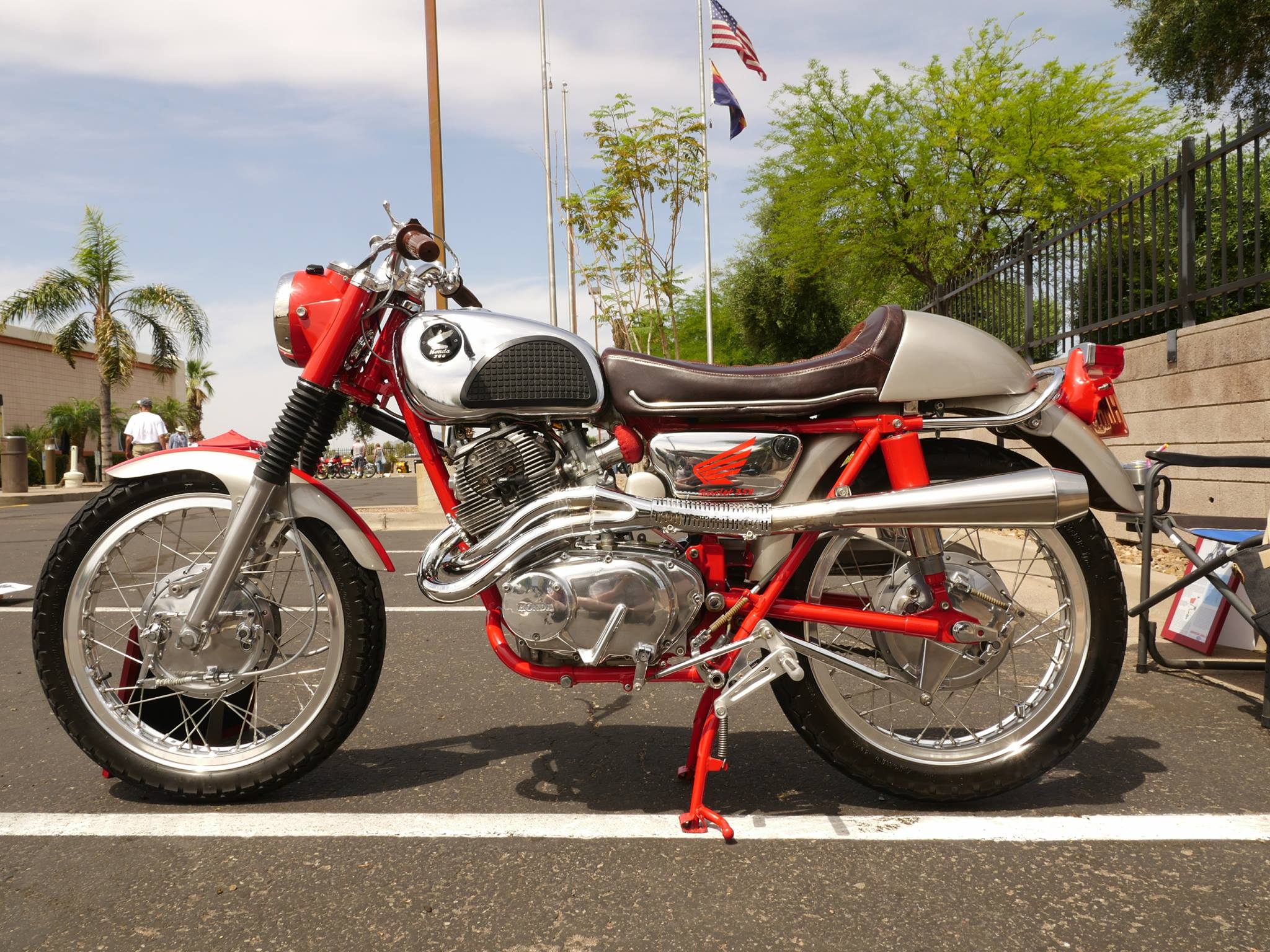

Post by moondoggers » Fri Nov 03, 2017 8:01 am
Mine is a custom build though IMHO polish is the way to present the restoration.
2017Shriners Scarlet.jpg (490.91 KiB) Viewed 2996 times
