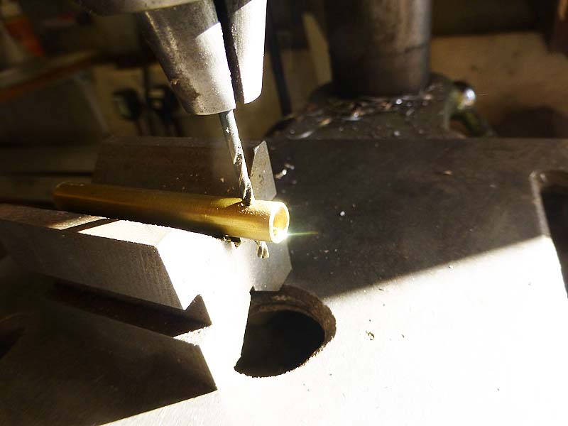

I have tons of 8mm thick-wall brass tubing left over from my production runs & found that it fits the new lever recesses perfectly!!

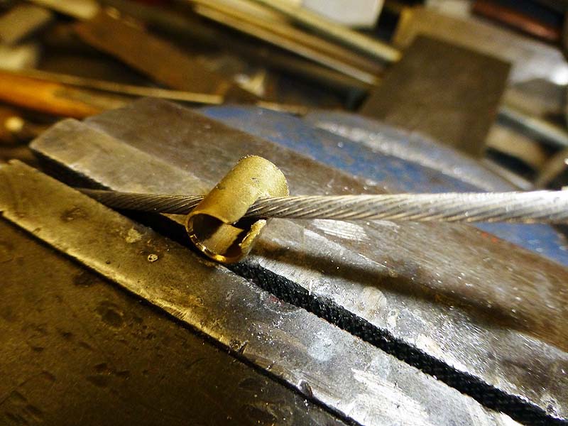

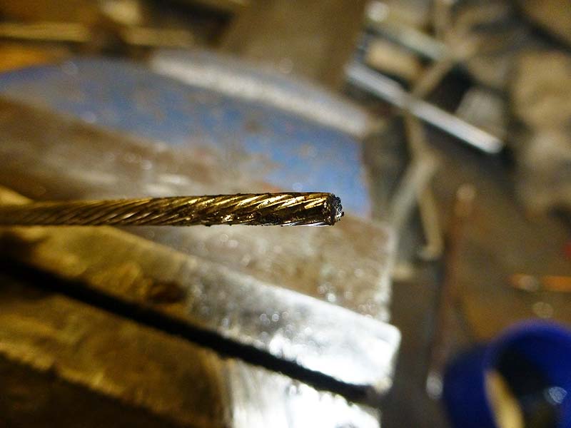

Drilled cable size hole in the tube, then slotted one side only, cut to length, placed onto cable, soldered the wire for about 20mm.

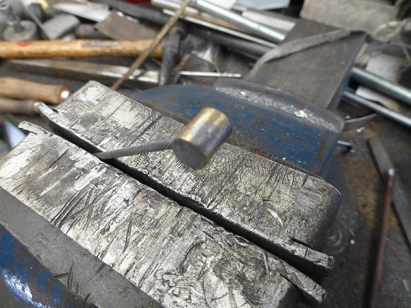

Put wire in vice with about 5mm protruding, hammer over to right-angle, bring tube/nipple to the end & make the right-angle fit into the slot.
Fill the tube assy with solder-paste, flood with solder, file to shape!
You will have a nipple that will NEVER pull through, & since its brass, should wear well.
