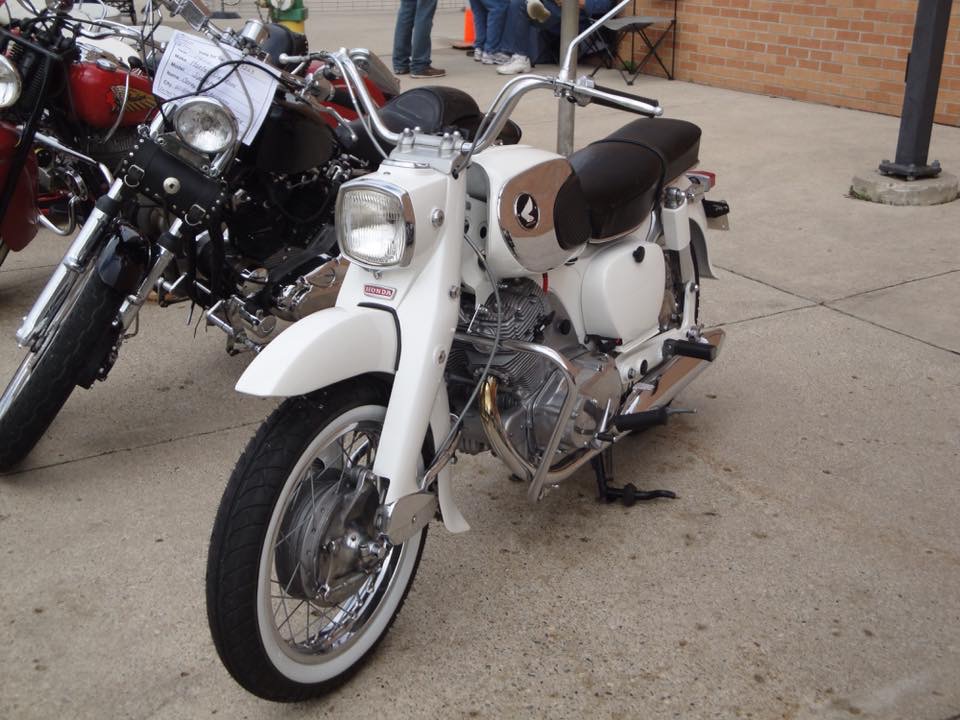

Members, is anyone aware of two different sizes of battery cover for the CA77 as mine doesn't fit close to the framework but is about 1/2" away.

Re: CA77 battery cover
Post by brewsky » Wed Nov 27, 2019 7:26 am
There were 2 different size batteries, along with different side covers and frame slots etc.
I really don't see anything wrong with yours from the pic?
The parts lookups will give the serial breakdown of the changeover.
Early had a wider battery and later smaller version. I don't think the early one is manufactured anymore, just some old OEM's turn up occasionally on e bay.

Hi brewsky, that is not my bike only to demonstrate how the cover should fit close to the frame.

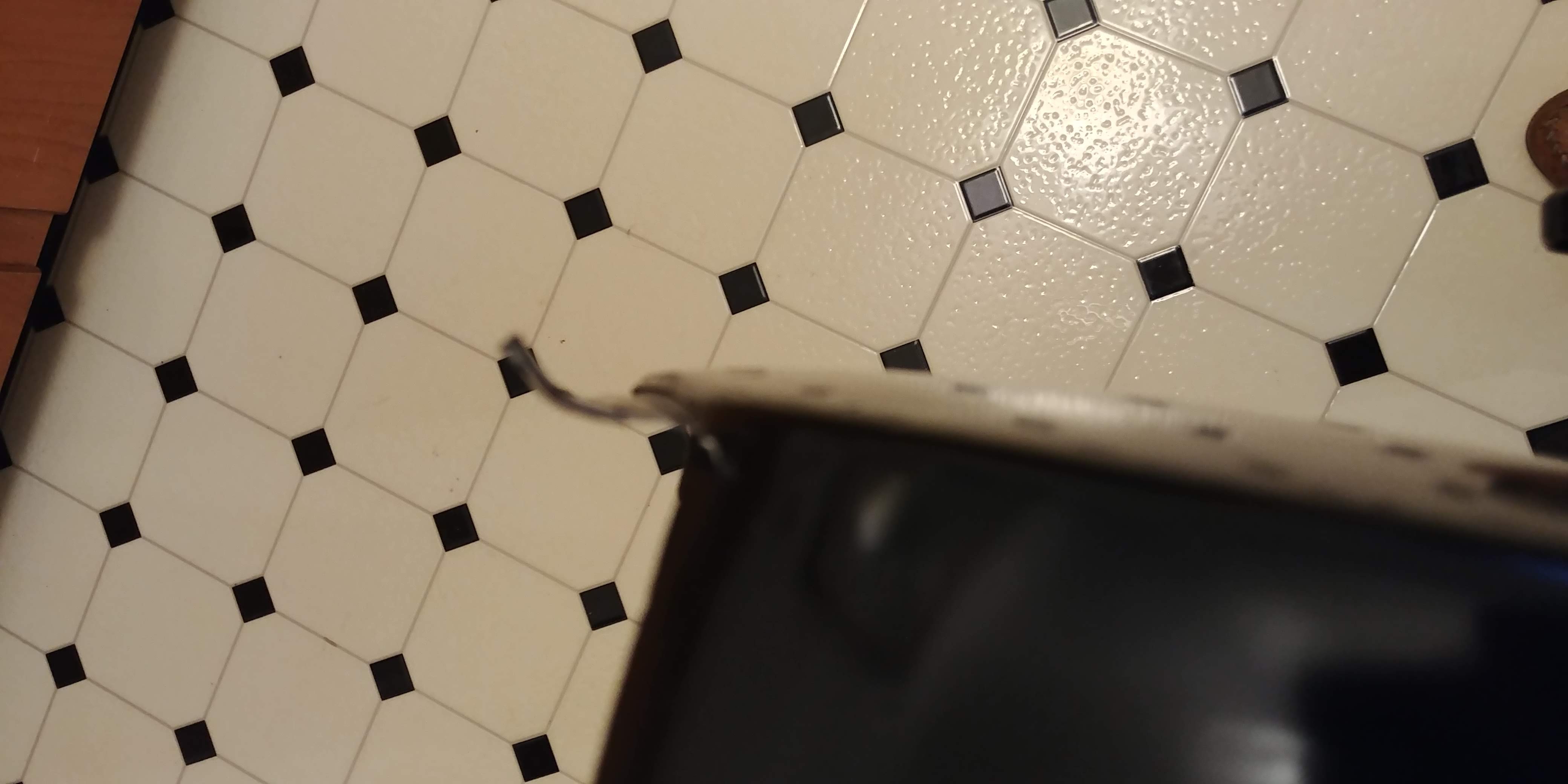

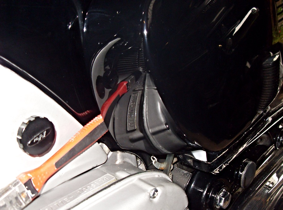

This is mine

Looks like you have a late cover in an early frame, or maybe not....a little hard to see as the paint is mirror glossy!
How about a side view?

The more I look at it, the more it looks like the bottom tab on the cover is bent inward.
It should be pretty much flush with the outside profile of the cover.
