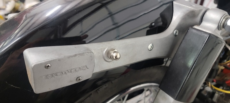

The trim on the rear fender that the shocks mount to... is it supposed to be polished, painted, or left natural? Forum search led me to one post which seems to indicate "natural". My parts bike has polished and the one I'm restoring had painted.
