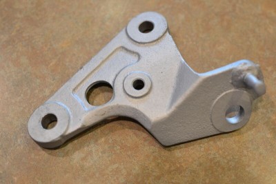

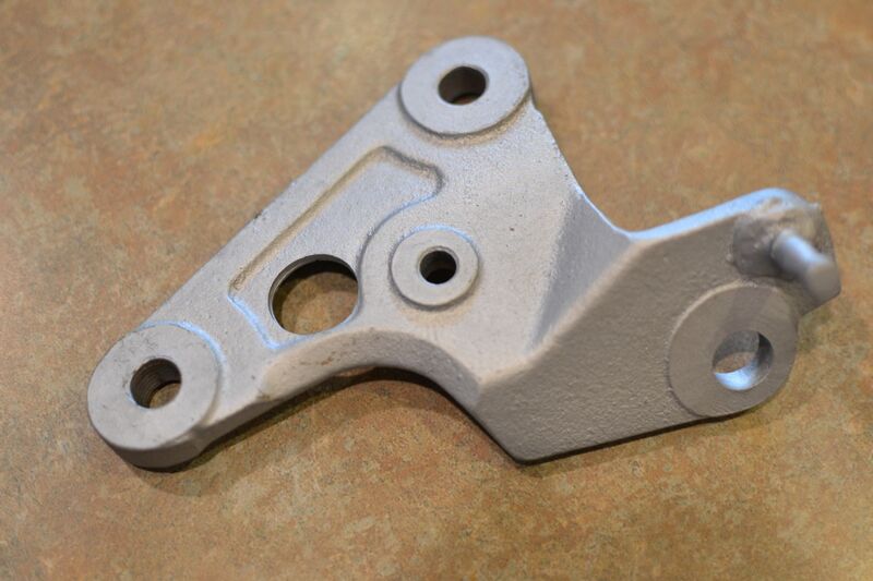

This part was attached to the frame when I tore the 65 CB77 bike down but my reference pics don't help me at all. Parts manual is not much help on that section. I think it is part of the left side step but what is it's purpose, how does it attach to the frame, and what attaches to it? This bike was cherry picked for parts so I know I'm going to scratch my head often and wonder "What am I missing"? I find I am a visual learner so if you could snap a quick pic and send it I would really appreciate it. Thanks in advance.

I think you have the mounting bracket for a sidestand. As far as I know the C/CA/CB72/77 models never had them. There were (and are still) aftermarket models available but Honda also installed sidestands on the CYP77 police bikes, I think, and it may be one of those.

Thank you. I took the bracket off the bike and put it back in the box. I'm thinking about putting it up on Ebay for $300.
