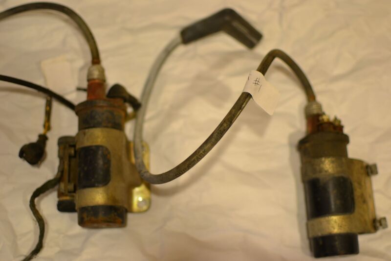

Here's a pic of my pretty rough coils, spark plug wires, and (I think) condenser. Connection caps on the coils completely rotted away. Spark plug wires look pretty iffy. My question is are the spark plug wires replaceable? I don't want to go yanking on them if they are not replaceable because I want to try to get it running with as much of the original setup as possible but one of the spark plug wires has a cut that goes into the insulation.

The plug wires are generic and still easy to find. I recently bought a length of copper (non-resistor) wire from my local wholesale and retail car parts supplier.
Assuming all is as it should be, you just need to unscrew the metal bits that fit onto the coils. There should be a rubber spacer underneath them. These are hard parts to find so even if they look rough you should keep and reuse them, assuming they are not too rough.

Thank you Tim. When the time comes I'm going to carefully separate the wire from the coil and not worry about creating a coil faux pas.
