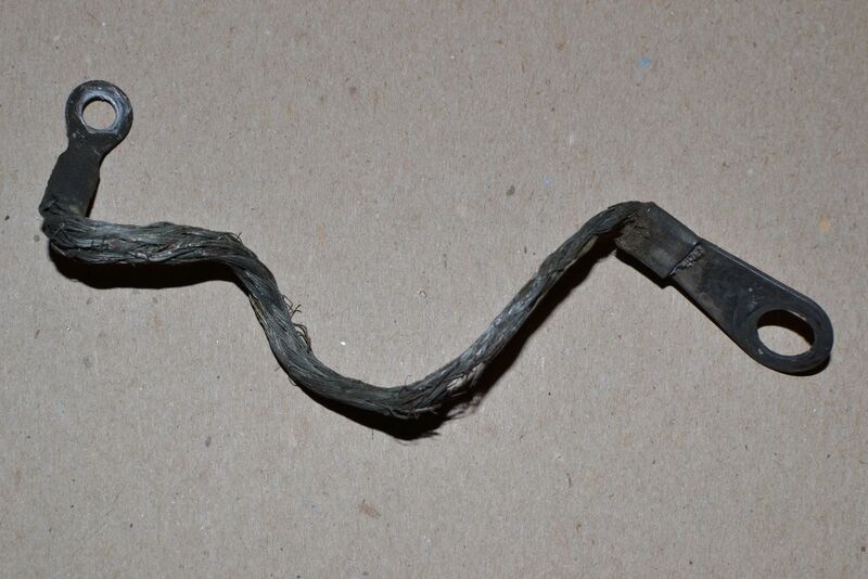

Here is a ground wire that I missed in the reference photos and during the bag and tag. I think it may be associated with the coils in some way? Goes on a 65 CB77. Any help with what it is and where it goes would be appreciated. Thanks, Bill

Looks like it's one of two ground cables for CB77.
#13 in parts diagram, p/n 32621-268-020: https://images.cmsnl.com/img/partslists ... 2_3616.gif
(Guessing it's this one).
or
#13 in parts diagram, p/n 32601-268-000: https://images.cmsnl.com/img/partslists ... 7_b7a4.gif

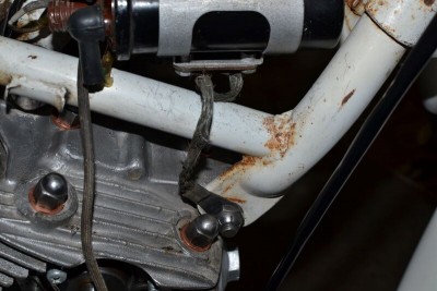

Thank you. It looks like this is the ground cable from the condenser to motor mount. Put it on and I could still see the "ghost" image of where it had been attached for the last 59 years. How many times have I said to myself, "Oh, I'll just remember where that goes", and a few months later have no idea. If I ever do another project like this again I am going to take a lot more reference photos because I don't know how many times I have flipped through them.
