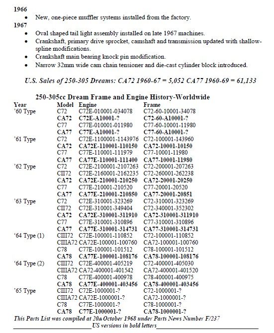

Is there a place that I can locate an engine serial number chart so that I can determine the year of an engine ?
A case that I have is CA77E-1020491 and I would like to know what year that is.

From some of Bill Silver's invaluable documentation:
'64 C72
'62 C72

Muddy that is awesome and just what I was looking for.
It would appear my engine is a 1964 (type one) .
