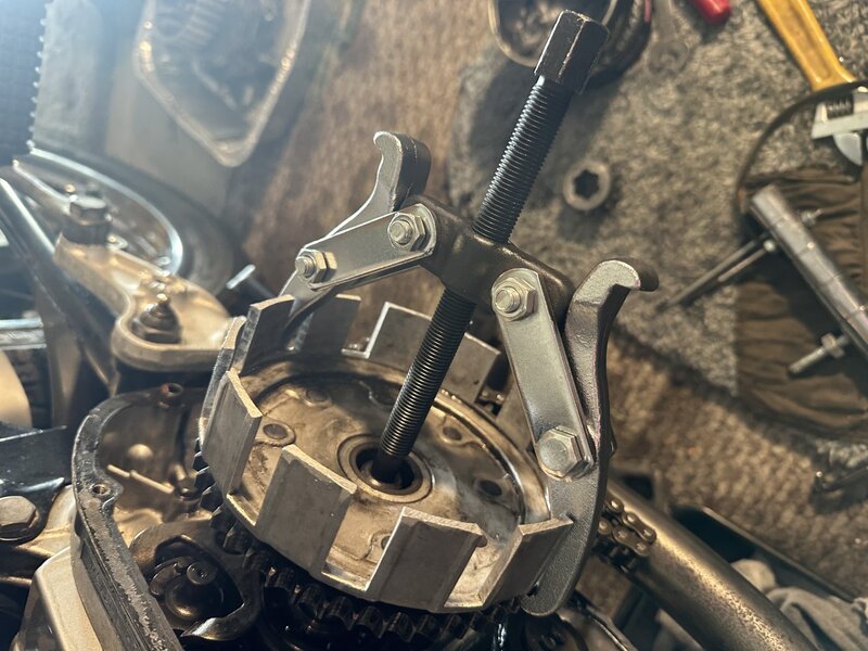

After much head-scratching (had I missed something?) and review of the worshop manual and more YouTube vids I decided that maybe a ridge had worn in the shaft and bearing so I decided to get a 6" puller and yank it off...
Easier said than done, a standard 6" puller doesn't quite get a purchase on the outer rim of the clutch basket with the drive chain in place, however it did look as if it would work if the chain was removed.

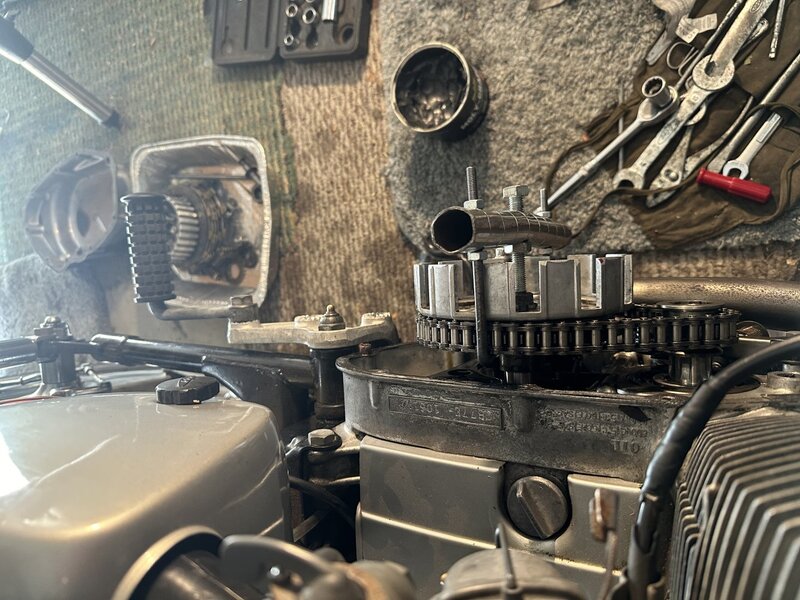

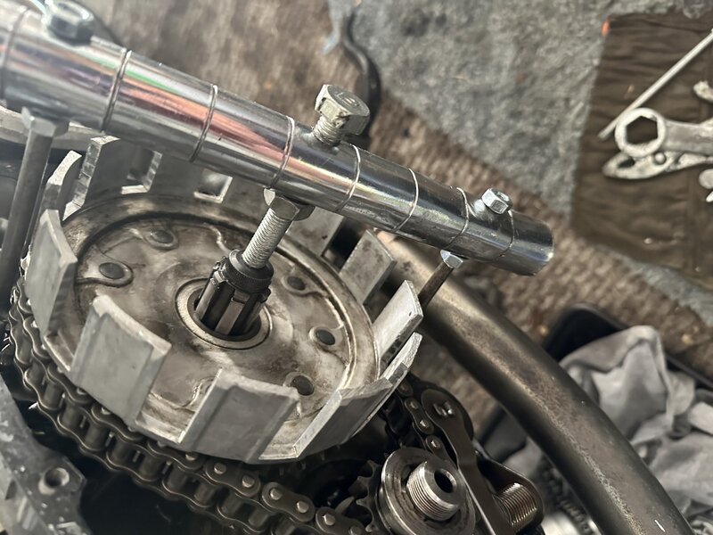

2. Make a puller that would do he job.
I had enough bits and pieces laying around so I decided to make a puller. (note that a larger puller is not an option - an 8" or 10" puller is far to big to get in the small space available)
After a whole day making a puller and carefully pulling and tapping,the basket was nearly off but my home made puller could not handle the last 1/4" or so (the basket was still solidly stuck to the shaft) luckily it had pulled off far enough to allow the chain to be removed from the small gear. This in turn allowed me to use the purchased 6" puller and finally the clutch basket was off.

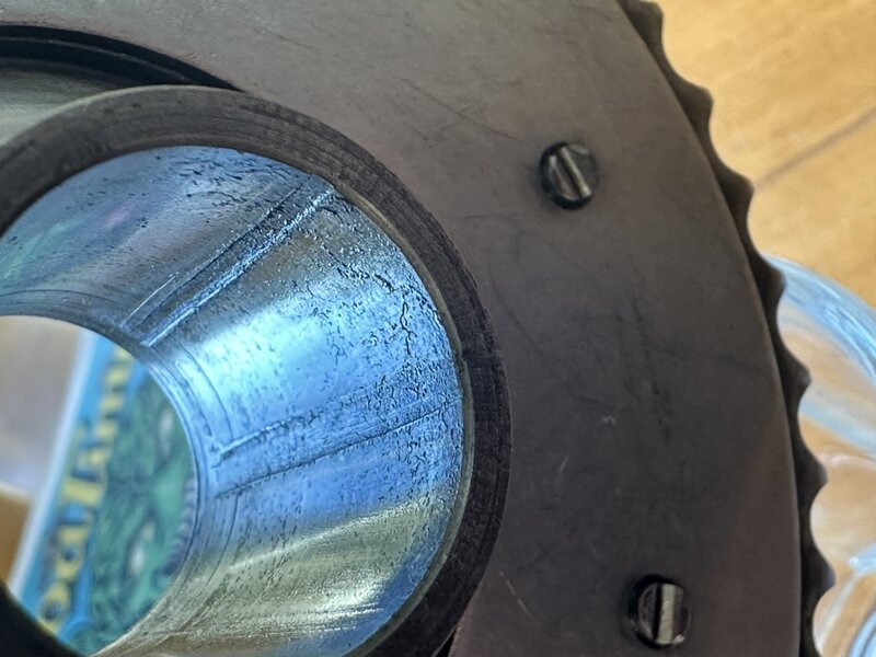

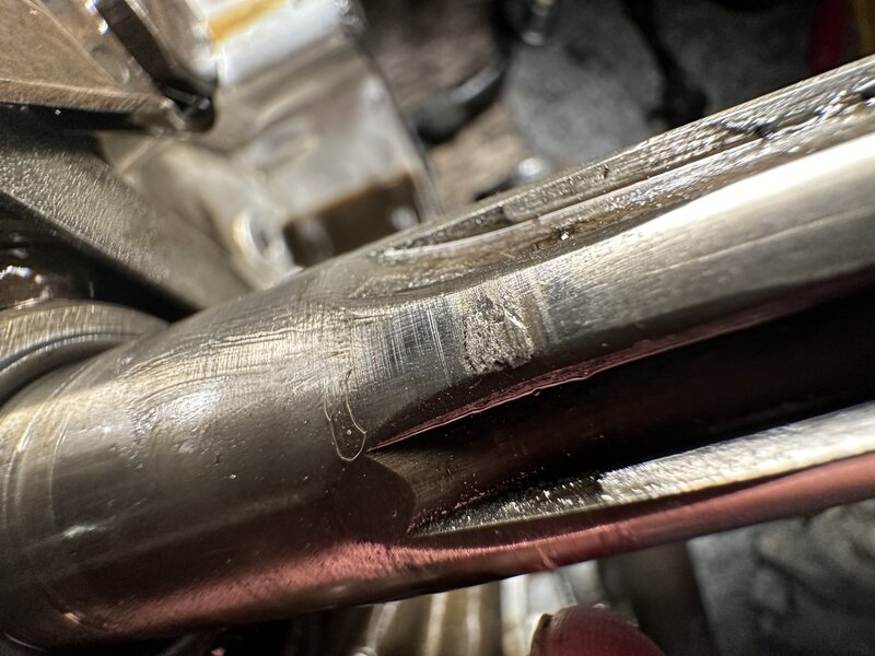

See pictures for details of damage, pullers etc anyone have any idea what caused the damage to the splines?
I think emery paper and some careful oild stone work on the splines should fix the problem.

I'm glad that you were able to get the basket off. From the pictures it looks like it may have been caused by oil starvation although I would expect signs of heating as well as the deformation. As you discovered online, everything should come apart easily. I hope you didn't bend the basket.

I tidied everything up, the spline shaft just needed a little emery cloth and I was able to put he basket in he lathe and polish out most of he damage.
