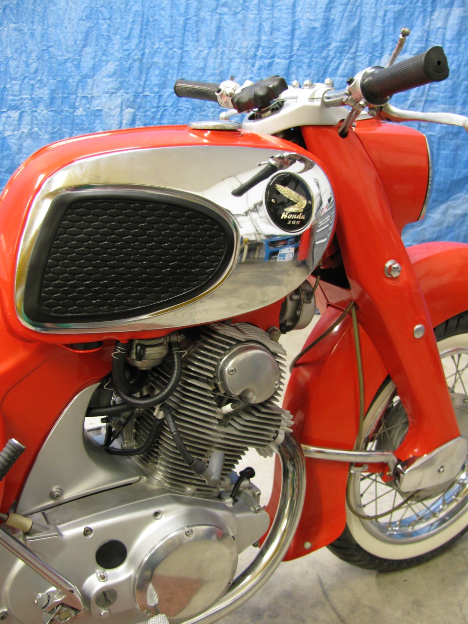

I just finished installing a set of used bars off an old Honda MT125. The bars were not perfect and were more of a "lets see if this can be done with manual tools thing...". I do not own a Mill and really don't know of any access to one, but I do own a Drill, bastard files and a Dremel tool. I've seen bar re-pops on eBay for about $50 plus shipping from Taiwan, but since I had the bars, what the heck.
This can be done and in my case, I'm so satisfied that I'm sticking with them. The biggest issue was the slot. Insure you take careful measurements and have your hinge slide available for continuous measurements. Length is not nearly as important (go a little long) as width (go a little narrow initially). For the slot I just traced out the cut with a sharpie and used the cutoff wheels (small ones - about 1 inch in dia) and started the cut. I ended up going through about 10 of the little wheels when all said and done so buy the package of them. After cutting the slot a little narrow, I used the file to clean it all up using the hinge slide to continuously look for burrs and catches. I think this was the most important part as you do NOT want that sticking - ever. Cutting the slot for the cable stop was pretty easy as well. Insure your length measurements to the start of the slot are pretty close to your original bars to keep your cable from binding. After getting the slot done, there are 3 holes - all sizes vary for the wiring and the throttle cable. For this I used drill bits and finished up with the Dremel reaming tool and a round file. Insure that all edges are rounded over. I put a little electrical tape on the wiring prior to install to keep any chaffing down as well. A small amount of white lithium grease on the throttle control parts and re-assembly. If there is ANY catching I will need to disassemble the right side and file it down a little more or scrape them, but it is a very inexpensive way to have neweer looking bars without limiting your self to brand new oversees re-pops or waiting on very hard to get and expensive NOS bars (or close) on eBay. Special thanks to Daveo for having a throttle grommet too! All in all, it takes about 2 hours of work.
100_3949 by nestwoodmotors, on Flickr
