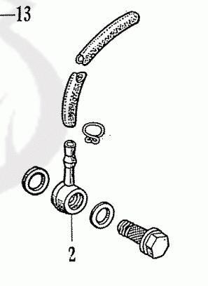

When I took my carb off to clean it, I noticed the fuel line that's connected to it didn't look right. There's nothing clamping it to the carb. It's just a little brass tube sticking out of the end of the line going into the carb. I looked at the parts manual and it looks like I'm missing some things! I don't have any of the parts shown in the manual. I don't know what the brass tube is sticking out, but I just wanted to check before I ordered the parts. It doesn't say what size that nut is either.

The DREAM carb has a threaded part at that location.
Ya show the CB/CL type part. .......lm
Kigsby wrote:When I took my carb off to clean it, I noticed the fuel line that's connected to it didn't look right. There's nothing clamping it to the carb. It's just a little brass tube sticking out of the end of the line going into the carb. I looked at the parts manual and it looks like I'm missing some things! I don't have any of the parts shown in the manual. I don't know what the brass tube is sticking out, but I just wanted to check before I ordered the parts. It doesn't say what size that nut is either.

Kigsby, the little tube end in your fuel line needs to be removed from the line and pressesd into the small opening just above the carb bowl that is shown in your picture.tap it in lightly with a small or soft hammer.it is just a press fit with no mechanical device to hold it in. The picture you posted from the parts manual has what is called a banjo fitting which is for a different carburator than yours ....jk
