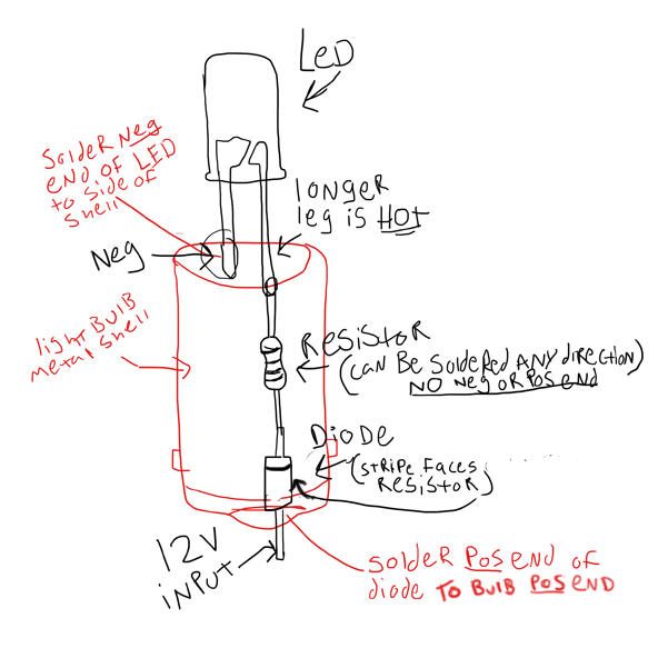

but for the people who want to DIY, here are the components and schematic:
Buy this (these) LED(s): http://www.mouser.com/ProductDetail/NTE ... NdgwNjY%3D
Buy this (these) Resistor(s): http://www.jameco.com/webapp/wcs/stores ... _690929_-1
Buy this (these) Diode(s): http://www.jameco.com/webapp/wcs/stores ... 1_36012_-1
sorry for the crap drawing of the schematic, but here yall are!
