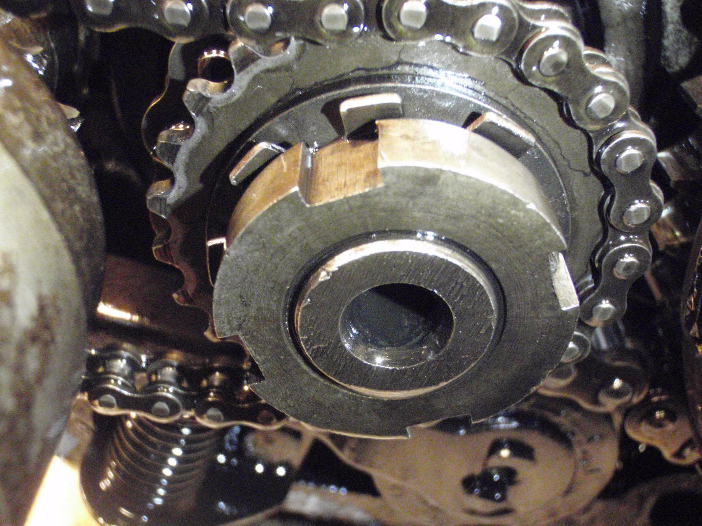

Last night I was disassembling an C77 engine, but the crank nut wouldn't come loose (in a normal way). Since I have no air powered tools in my garage to loosen it, and using a chisel is not my style, I tried to disassemble as far as possible without taking the nut off.

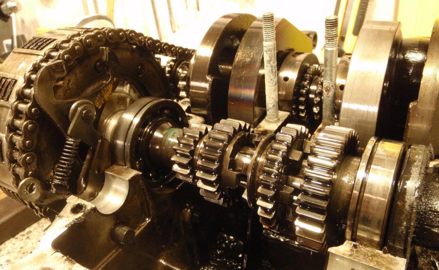

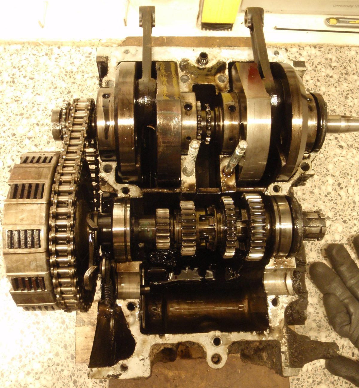

I tried to split the cases without taking the crank nut and clutch off, and guess what ? it can be done. First remove the 10 mm bolt that keeps the 'shift drum stopper guide (p/n 24440-259-000) from the upper case (it can be reached without getting the clutch off).
While you split the case push the gear shift arm gently to the clutch, and the cases will split with everything in it. I already disassembled the cylinder and head, but that ain't necessary either. The only thing you have to do is keeping the crank and both shafts into the upper case while splitting.

For those who want to inspect the crank, shift mechanisms, or the counter shaft issue's this method saves work and time.
