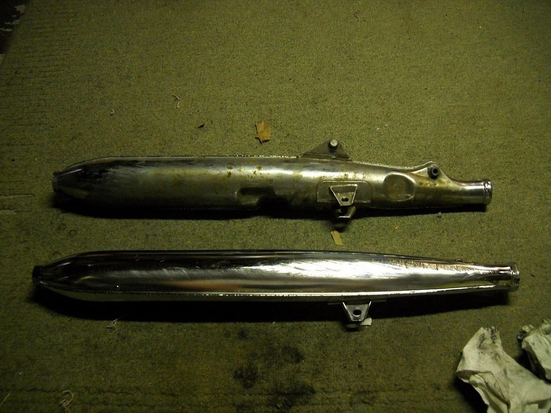

Thanks for the tip, conbs. I thought they were too far gone, but after an SOS pad and some orange pumice cleaner, they came out looking salvageable. Here's a before and after shot. Still have some work to do, but I'm sure it will be much cheaper than replacement. Any suggestions as to what to run through the inside to clean up any corrosion and carbon? Also, would it benefit me to replace the baffles inside the mufflers with new?

The best advice I can give is to use the search function on this site liberally. It is not the best, but if you try lots of different words and combinations of words, you will almost always find something that will be helpful. You are not the first guy to wrestle with the problems an owner faces. Someone has been there before and likely found a way to prevail.
I have not heard of an effective way to replace the baffles. Installing diffusers may help quiet things down some. But, again, use the search function and you will likely find advice from somone a lot smarter than me.
BTW, I like Flitz because it leaves a protective layer on chrome and aluminum after you are done. There are other products that do that, too. I have never heard of using orange pumice cleaner.

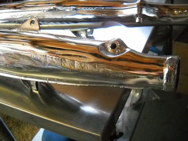

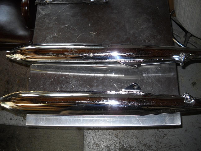

I've gone over these mufflers several times with SOS pads, orange pumice cleaner, flitz, and Mother's polish. They have cleaned up much better than I thought they would.
