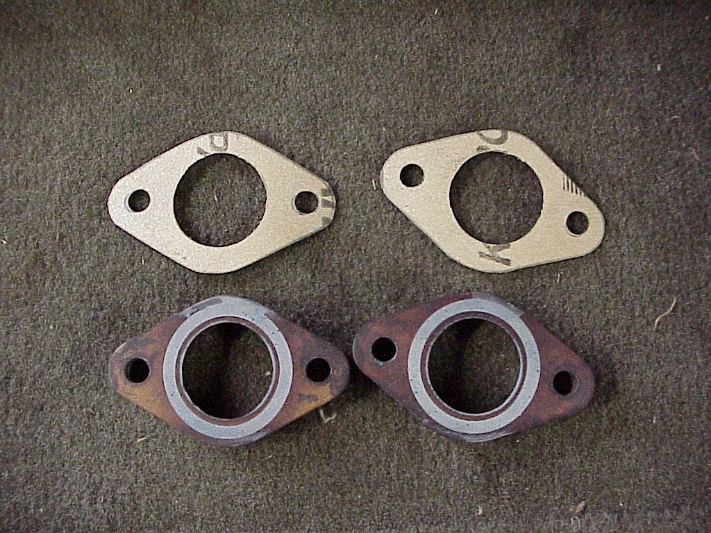

Problem solved.

Good job on the gaskets.
Whenever I have to make any, I soak them in oil first brfore using.
Don't really know why, just seems like a good idea???
Snakeoil
Posts: 1150
Location: Upstate NY
Post by Snakeoil » Wed Apr 09, 2014 7:28 pm
Thanks. I have a lathe so I can make punches any diameter I want.
regards,
Rob

O ring
Post by moondoggers » Wed Apr 09, 2014 9:30 pm
O ring faces out to the carb flange to seal against air leaks not against the hot cylinder head.
Hoosier Tom
Posts: 817
Location: Logansport, IN
Re: O ring
Post by Hoosier Tom » Wed Apr 09, 2014 9:47 pm
moondoggers wrote:O ring faces out to the carb flange to seal against air leaks not against the hot cylinder head.
Not sure you are understanding the setup of the spacer. There are two o-rings used to seal each carb to head. There is an o-ring between the carb flange and the outboard face of the spacer and then a second o-ring between the inboard side of the spacer (sets in a machined groove) and the head. Rob's issue was on the inboard side of the spacer where the o-ring resides in the machined groove that seals against the hot cylinder head from air leaks.
