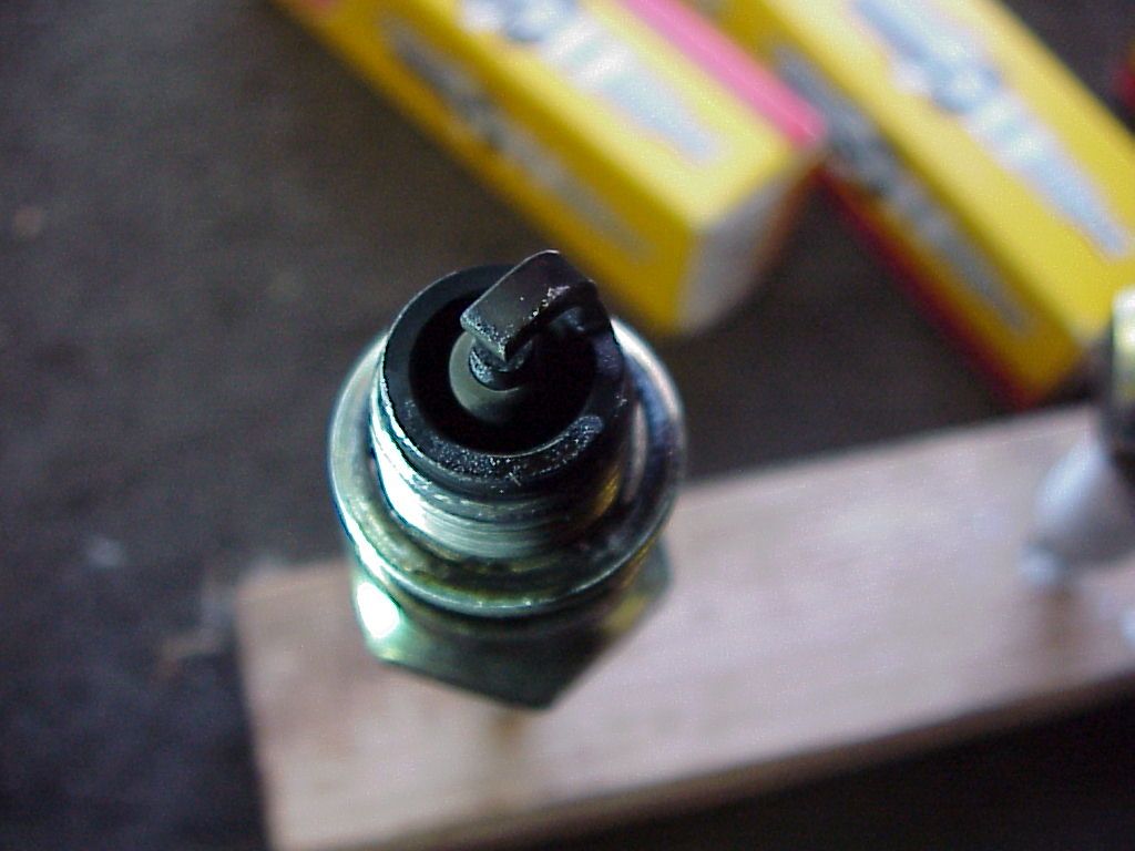

First, I put that bad plug into one of the plug caps and kicked the engine. Plug sparked just fine. Checked it again and still zero conductivity. Strange.
Today, took the bike for a sprited ride in damn cold and windy conditions. Last few miles were downright unpleasant.
But, had the engine at speed and signing like a bee and did a plug chop just before my driveway. It's not easy on a CL since the key is on the same side as the throttle so you have to let go to kill the engine. Not really a plug chop in the intended form.
But it shed some more light on the problem.

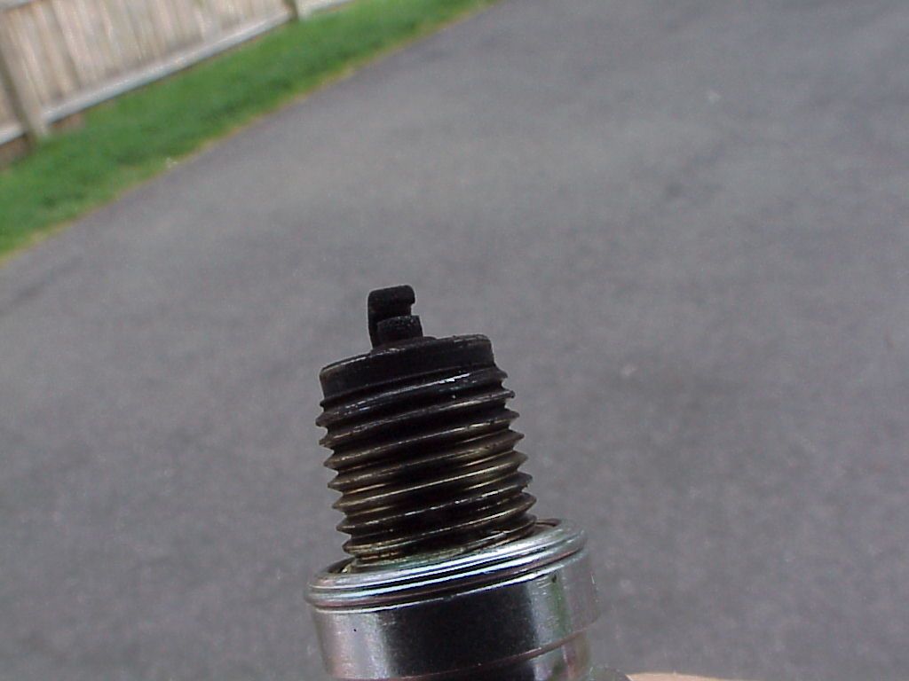

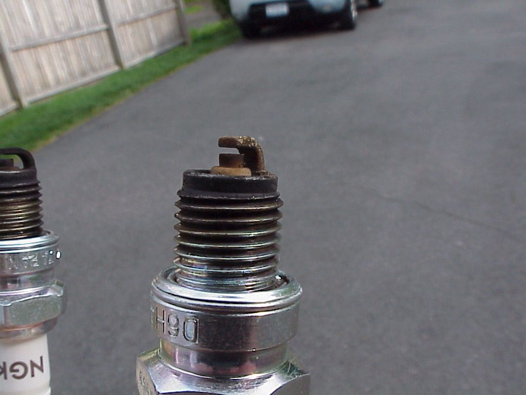

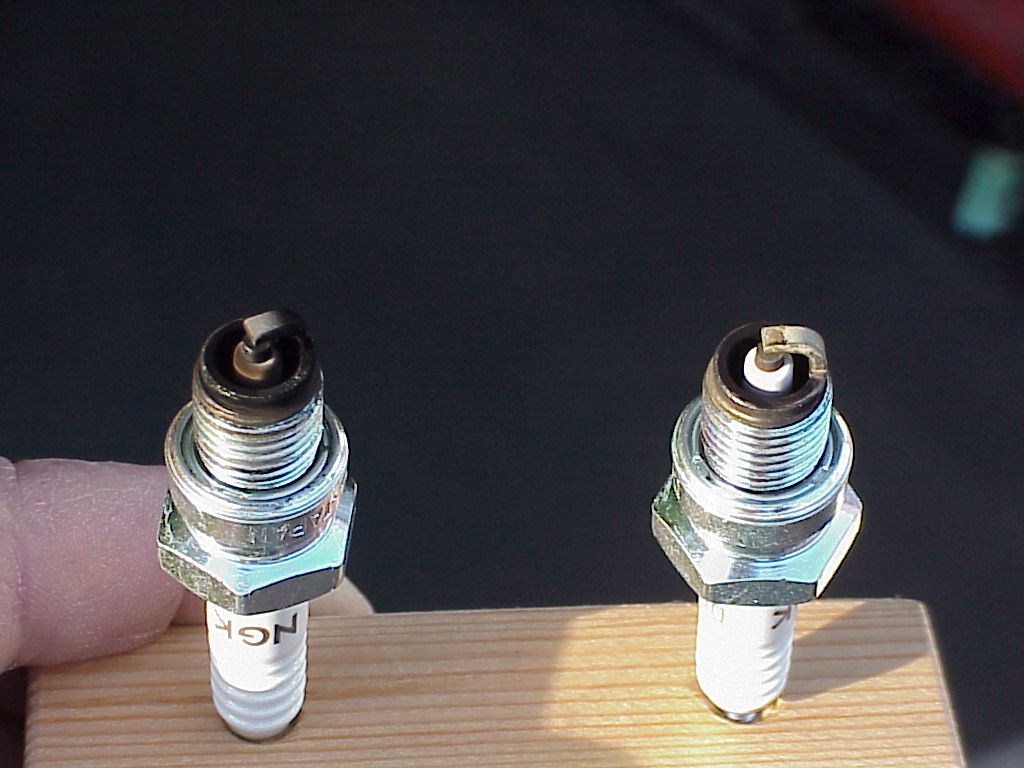

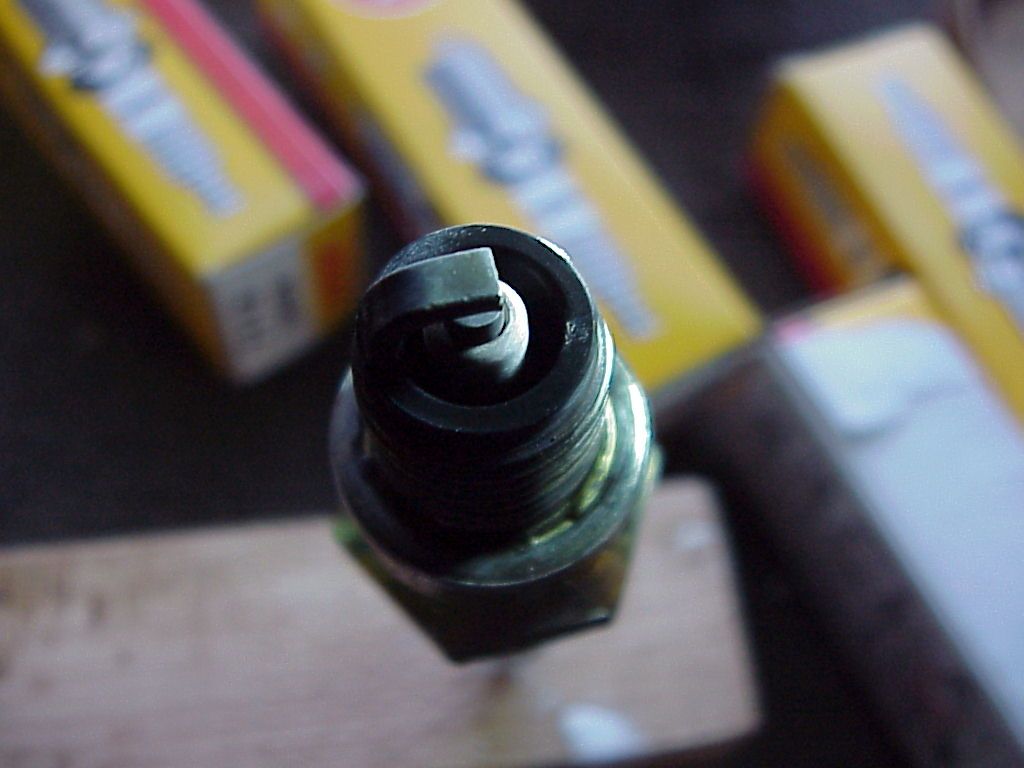

Right plug was nice tan color and no soot except a bit around the periphery of the plug thread end. Left plug has a sooty insulator and baked carbon deposits on the electrode. So, I think my oil burning issue is worse than I suspected.
Here is the right(good side) plug
Here is the left (oil burning side) plug
I put a light down the plug holes on each side and saw similar results. Right piston top was clean with signs of flaking carbon. Left piston top was black.
I'm going to try a D6HA in the left side to see if it helps with the deposits. Looks like I'm going to be doing a top end rebuild next winter. Will probably swap the tranny gears at the same time. I've never owned a bike that was geared as poorly as this CL.

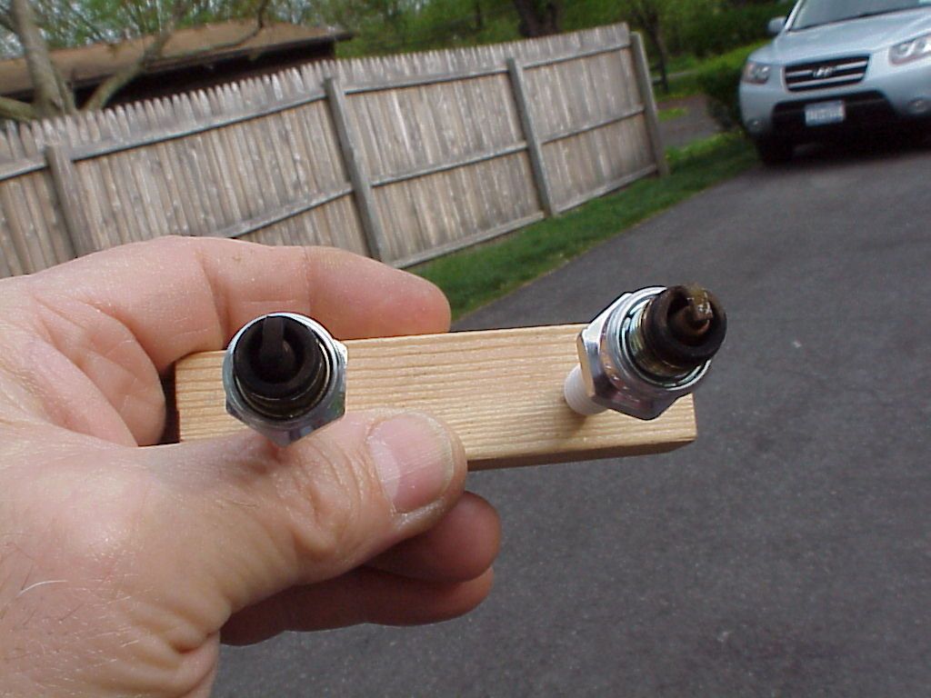

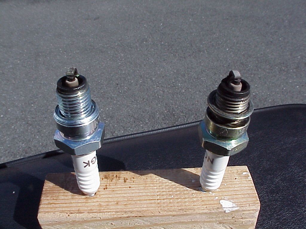

I put a D6HA in the left cylinder and the fouled D8HA from the left side into the right cylinder and did a short 6 or so mile run with a plug chop at the end.
D6 looks much better than the D8 did in the left cylinder. D8 in the right looks okay, but fouling was still down at the base of the insulator. Electrode looked much better.
Pics show D6 on left and D8 on right.
I put a D6HA in to the right cylinder and will so how that works out. I'm starting to get the feeling that the new E10 gasoline requires a slightly hotter plug.

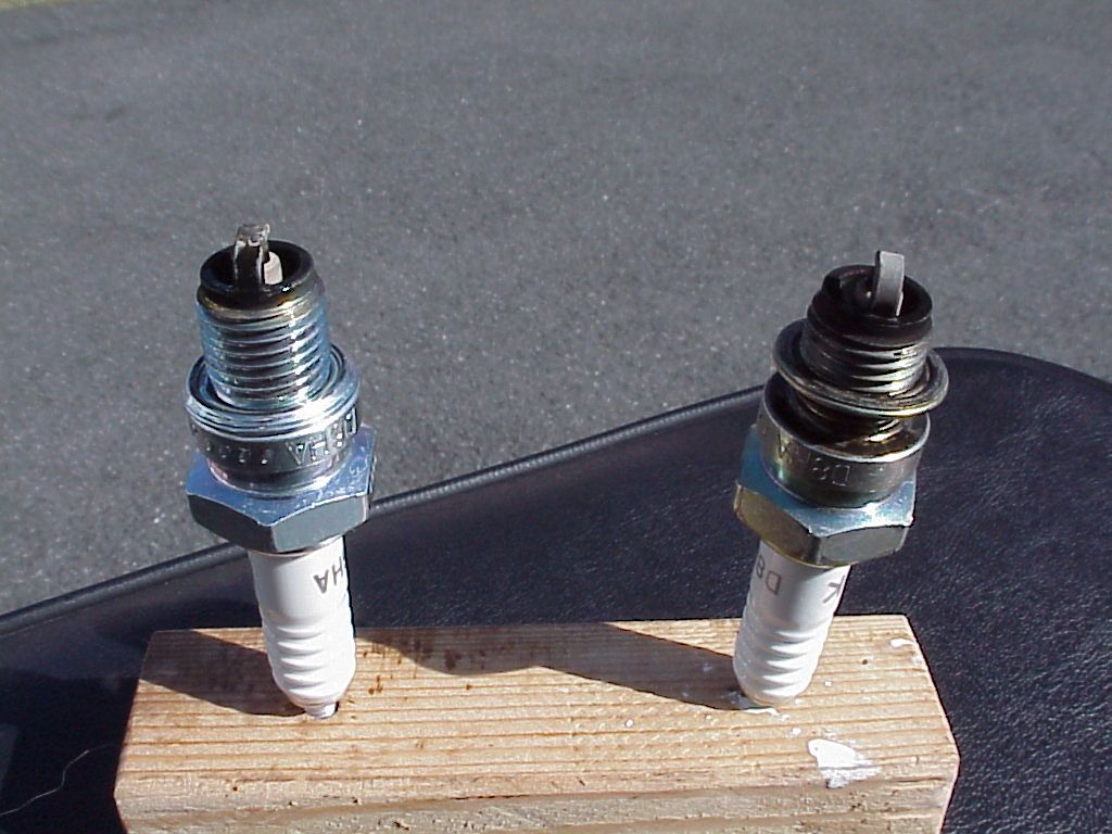

D6HA plug chop results
Today was in the 60's and it was perfect for taking the bike for a run and doing a plug chop at the end.
Put about 38 spirited miles on her and then on the straight run home, kept her loaded but in the mid-throttle range of maybe 55 mph. Killed the ignition pulled in the clutch and coasted the 100 or so yards to my house.
Here are the plugs after that chop, oriented as they are in the engine.
Right insulator is as white as the day I put it in. Left is sooty. But the left mixture ring looks okay. Remeber, left is the jug that just barely puffs if you rev it while sitting still.
So, I'm going run these plugs for a bit more and do another chop. I'm coming to the conclusion that I need to run a D8 in the right jug and a D6 in the left.
One other observation is I still have that dry fluffy soot on the rim of both plugs. I think this is related to the gasoline we get now. I'm going to start doing plug chops on all my bikes, all of which have no running/mixture issues, just to see how they look and gather some more empirical data. If the dry soot on the rim is fuel related, I'd like to confirm that so it can be ignored in the future.
And the issue with running on one jug seems to have gone away with the replacement of the plug wires (knocking on wood here). She starts on the first kick with full choke and immediate movement to no choke. Idles perfectly. I really think it might have been moisture and old wires that were causing the problem. Gotta go see my friend that dropped off the chunk of new solid core and thank him again.
For those with a similar problem, I did trim the ends of the original wires and I cannot say with authority that it helped. Bike did run on 2 jugs after doing that, but then the problem came back. So, this has what has led me to believe the plug wires were the root cause. They had served their time and it was time to replace them. I guess we'll see at the upcoming Motogiro. All the issues always show up at the events, don't they?

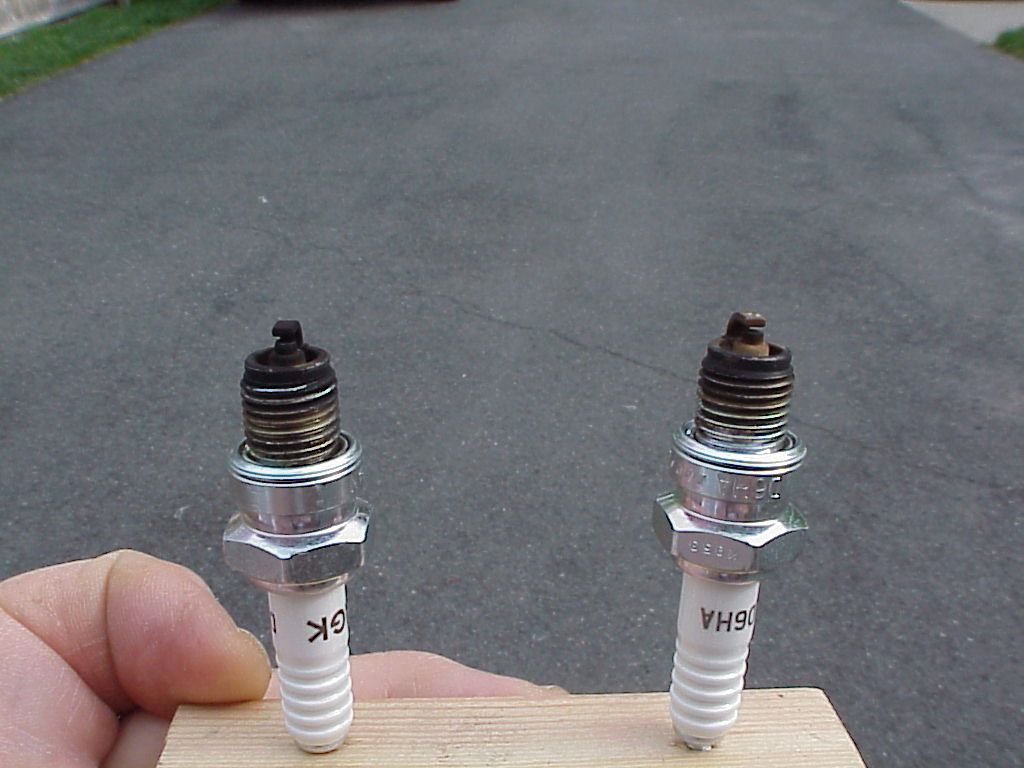

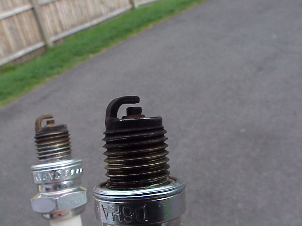

Thought I'd give a final follow up on the issue. First, no reoccurrence of firing on one jug since last posting. I think the new wires solved the problem.
But, I also ran D6HA plugs in the Motogiro this last weekend. About 300 miles of constant flogging of the bike and she ran like a raped ape. Only issue was idle was strange. It would idle perfectly and then for no reason die or almost die and then regain a perfect idle. Might be chunk of dirt in the carb idle circuit. But I'm leaning towards worn slides.
Anyway, point of the post is to report on the D6 results. Here are pics of the plugs. Pics of the pair show right and left plug. Left is the jug that appears to burn a tiny amount of oil. But not enough to worry about. After the first day, I added about a pint and she was back to full. I forgot to check it today (had other things on my mind in the form of a 439 Indian).
So nice brown plug in the pics is the right jug and black plug is the left. Note the small build up of soot on the electrode of the left plug. This is only on the front portion of the plug, opposite the attachment point of the outer electrode. I think the D6 helped cook off the oil fouling on that side.
By the way, these are not plug chops, but the plugs after a 5 mile flat out run at WOT and then coming into the checkpoint and pulling my bike into the trailer.
