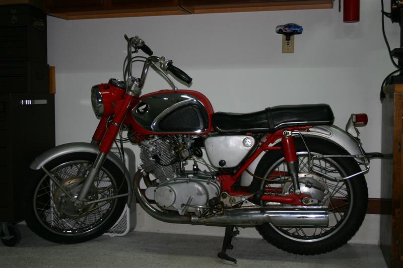

I think so. My other Super Hawk will go back to stock:
CB77 001 (Medium).jpg (55.73 KiB) Viewed 2043 times
