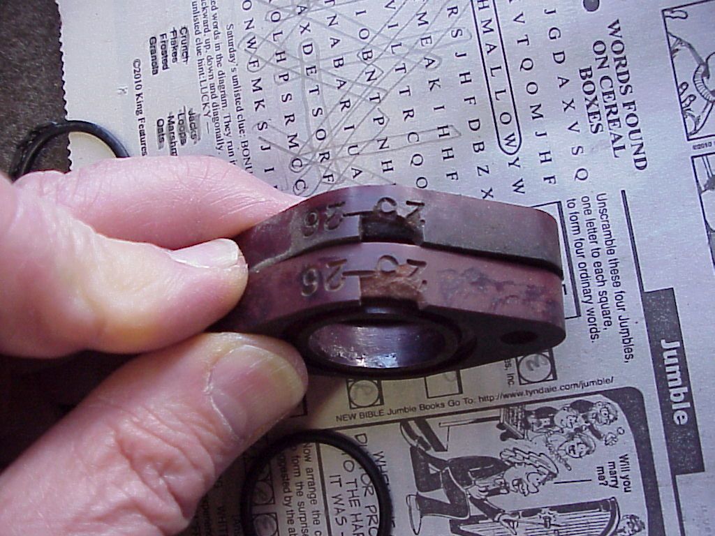

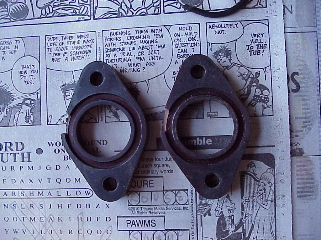

Here is the insulator I found today and the one I found a few years ago. Note that the failure is identical. The one with the light tan facture surface is the one from a few years back.

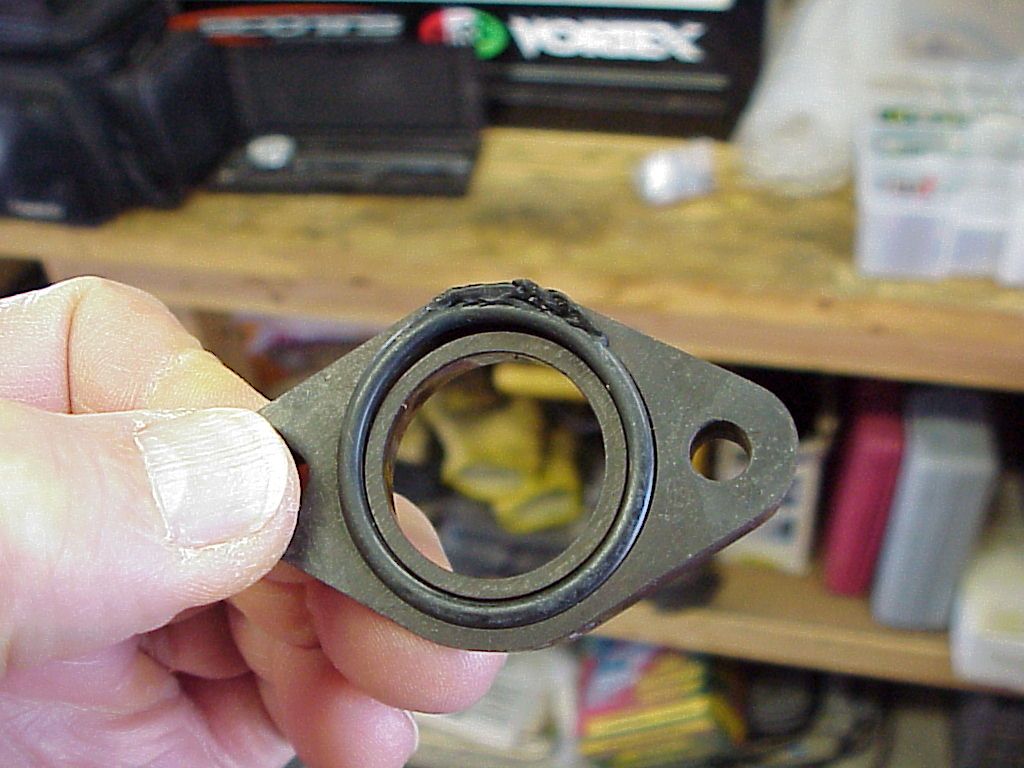

Here is how today's find looked when I removed it from the engine.
Here is what the undamaged insulator looked like with the o-ring trying to escape.

I suspect that the O-rings, which were sourced locally, may be expanding from exposure to gasoline. I think they are nitrile, not Viton. I may have also put in a size that was a tad too big and expansion has caused them to burst thru the side of the insulator. Both were broken where the numbers are engraved, which makes for a stress riser at that point.

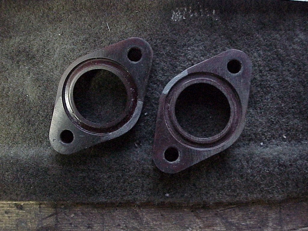

Change my mind. Fixed them so they are as original and still use the o-ring.
Used JB Weld Kwik because it has a higher temp rating than normal JB Weld. We'll see how it holds up to the fuel. My tests with JB Weld and ethanol laced fuels shows it does get rubbery. But as long as it does not lose it's bond, it should be okay. Plus, there should be no fuel on the repair side.
I had a square cross-section rubber ring I used to form the groove wall. Couple coats of Johnson's Paste wax worked good as a mold release. Used masking tape for the outside form.
Here are the repaired insulators.
