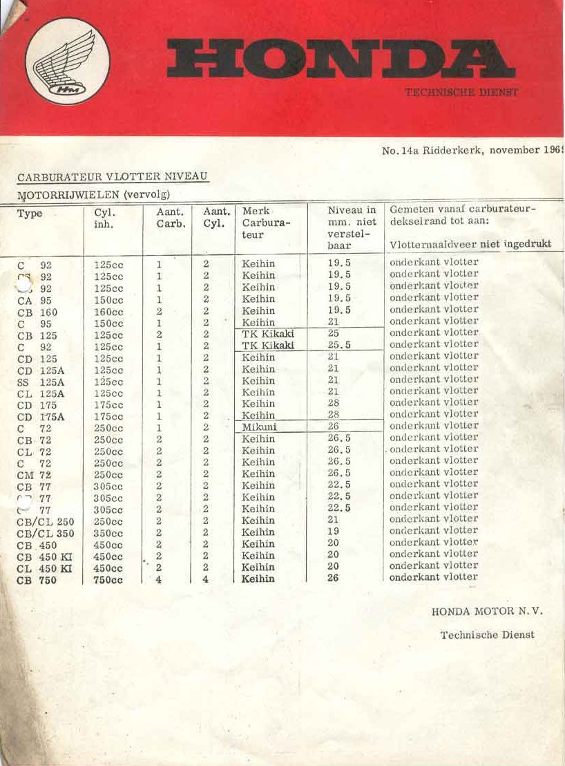

Found this between my stuff, it's a float hight sheet for different Honda models :
vlotterhoogten van diverse klassieke honda motorfietsen.jpg (178.96 KiB) Viewed 1515 times

Does it show C72 and C77 models with twin carbs?

Yes, but I think that would be an error in the page. But there is a difference between the C72 with Mikuni and Keihin.
