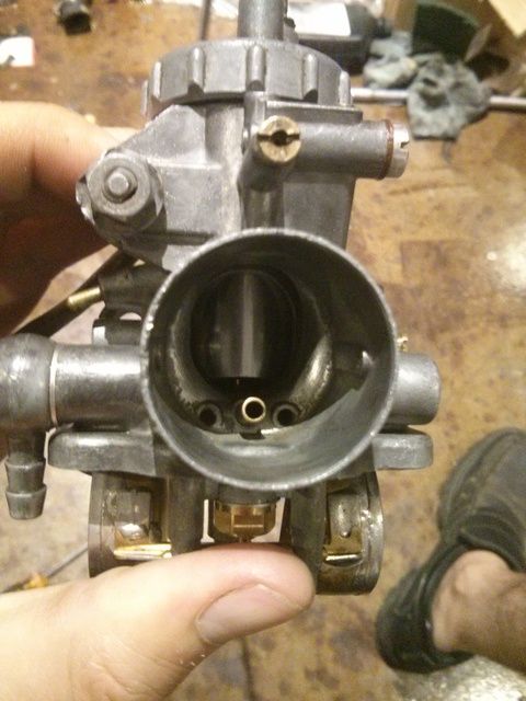

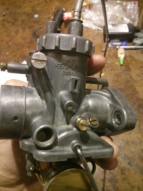

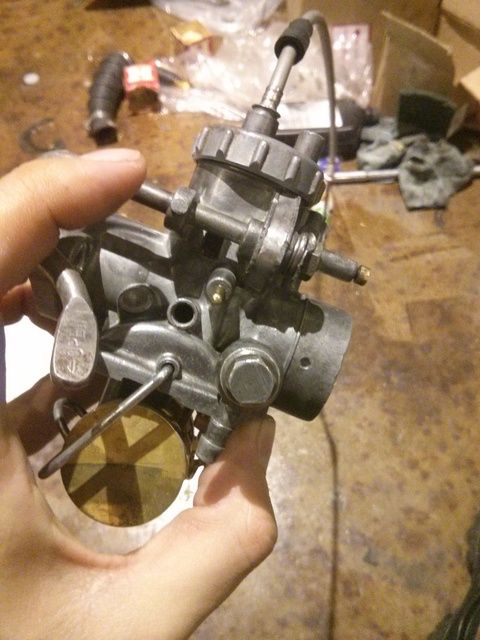

Ok so I would like to start the bike is a ca77 and I "rebuilt" this car with having zero knowledge on carbs prior to this. Basically my rebuild was to clean real well and put the rebuild kit parts where I took out the old parts. Now since I went back and put ca77 jets back in but as you see in the next pic this isn't a ca77 carb apparently. Not sure what it is off of? It was on the bike when I got it but had been many decades since last ran. Big questions: what is it off of? Will it work? And why is there a jet on the outside of the carb!? :P

It is a right side CB72, Power Jet carb......................lm

So what is the jet on the outside of the carb for? I am just gonna clean up another cab I have which looks to be a true ca77.
Post by LOUD MOUSE » Sat Aug 08, 2015 12:20 pm
That jet would allow more gas into the intake as the amount of air passed through the intake.
Back in the old days fellers would block that off and not use that system.
Similar to the CA72/77 carbs it is a 22mm carb. ..........................lm
